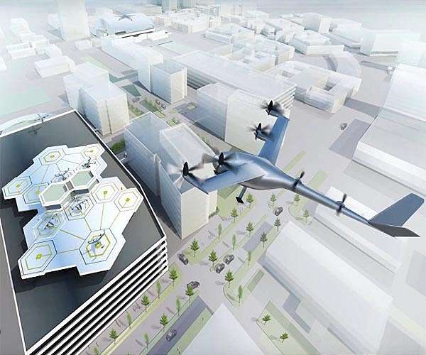

VTOL On Demand Mobility
He would better do cover art for modern mechanics...
Reminds me somwhat to Luigi Colani, but I have to say Colani design at least looked much better...
Ah it’s by Oscar Vinels;- the same genus that brought us the nuclear powered flying hotel aka the Sky Whale.
Utterly clueless about practical aero design and engineering but employing a world class marketing department…
De design brief is obviously: draw me something futuristic that will attract media attention and hopefully catch the eye of potential investors.

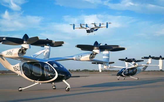

Discussions for Opening of Joby dedicated flight school:
If approved, Joby Aviation College would occupy 6,709 square feet of office, hangar and storage space at $5,416 per month, and another 3,840 square feet of dedicated ramp space for approximately $385, according to the City of Watsonville. The rent will adjust each year in July in accordance with the consumer price index.

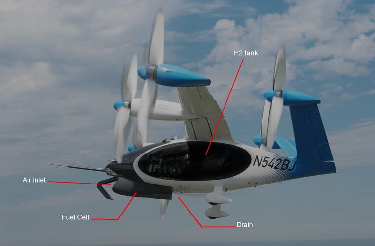

Almost 5 hours of endurance is impressive! However, I think a large fraction of cabin space is used for the hydrogen pressure vessels and associated equipment. The pod mounted under the fuselage appears to contain the fuel cell only.
You are right but it doesn´t matter much as the vehicle isn´t optimized for this propulsion and the range is way beyond their targeted claim.
Notice the drain pipe size and location that I pointed as a give-away detail for the presence of a fuel cell on the XRQ-73

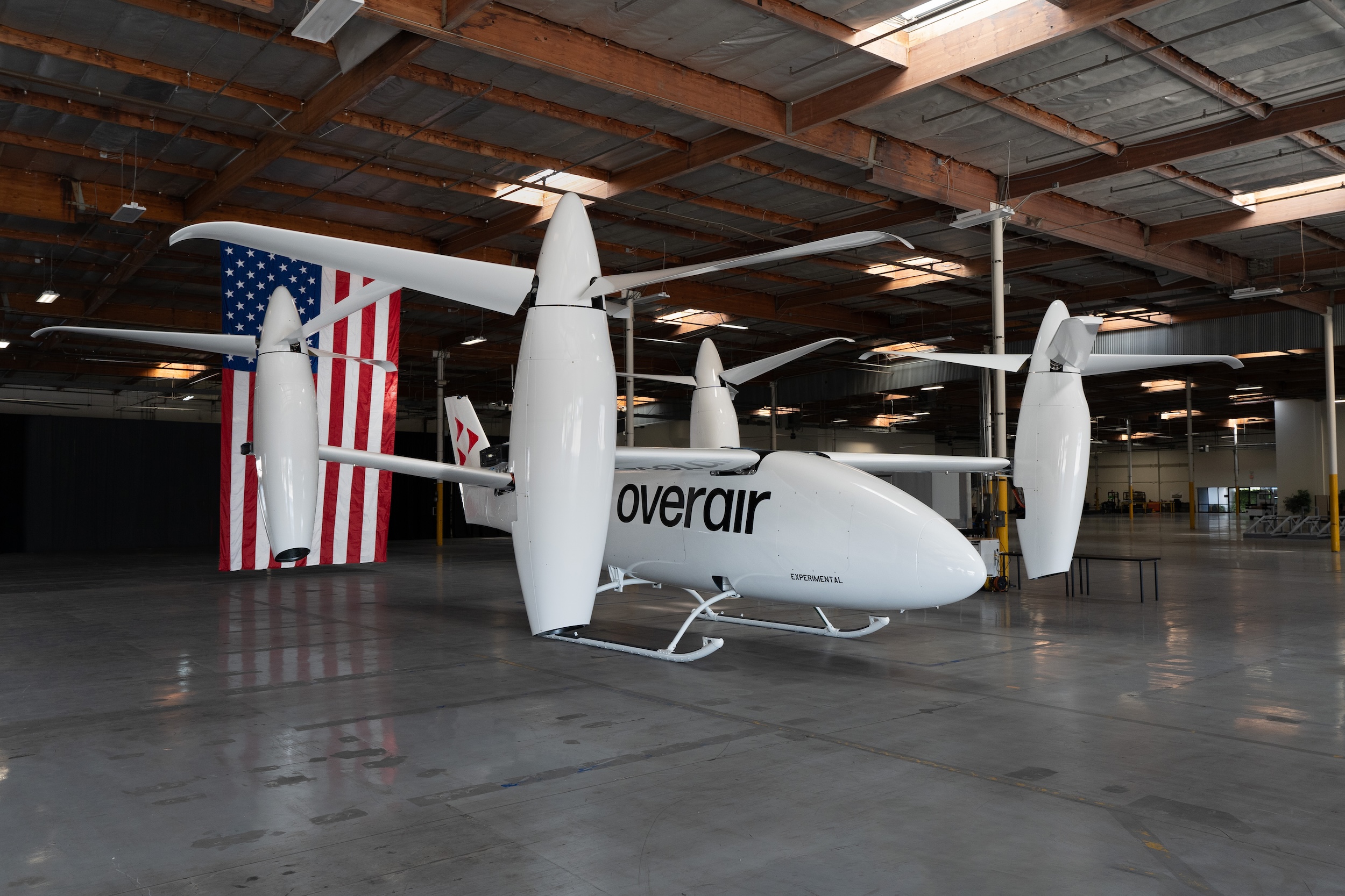

Overair is a spinoff from Karem.
Another big financial move (but reverted here) in Japan:
Too bad they never made the demonstrator aircraft fly.
