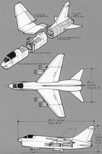

Some additional unbuilt projectsVought A-529D
Twin F404 engined version for the Navy
Source
  • Al Adcock A-7 Corsair II in Action Squadron-Signal, 1991

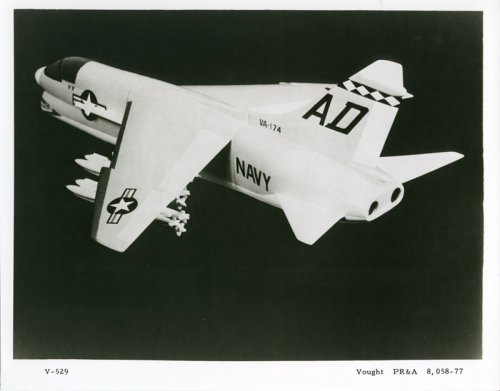

Thanks for this tread ... here are two illustrations of this twin-engined version !
Deino
Deino
Jan 2, 2006
2,732
506
Just found at the ARC ... posted by "Phantomologist"
Cheers, Deino

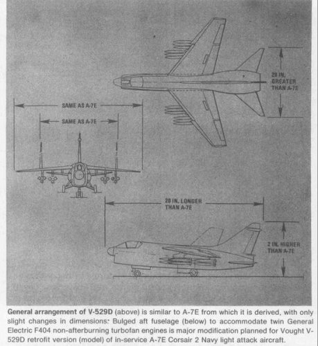

I thought, we had the the V-529D here before, hadn't we ? Or is this another
variant ? ???
(from Aviation Week .11.77)

Ah I see these beat me here. There was also a proposal for a two seat, twin engine A-7D rebuild
called the V-531.
bill
(phantomologist on ARC)

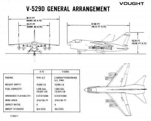

Twin-engined Corsair proposed
A TWIN F404-engined version of the Corsair II has been proposed by Vought as a future US Navy light attack aircraft. The two General Electric engines would total over 50 per cent more thrust than the single 15,000lb Allison of the A-7E. Vought has already built more than 400 A-7Es, and the type is in service with 24 USN squadrons. Although the force has so far flown for more than 750,000hr, the manufacturer claims that a typical squadron aircraft has more than 17 years of service life left and could soldier on into the 1990s. The proposed V-529D version is almost identical to the A-7E except for the two F404 engines, new tailpipes and a wider rear fuselage to house them, and 20in fuselage stretch to keep the e.g. within limits. Both engines would be fed from the existing nose intake, a bifurcated duct splitting the incoming airflow between the two powerplants. Maximum rear fuselage width would be only 29in greater than at present. Empty weight would rise from 19,050lb (A-7E) to 19,952lb as a result, but the internal fuel load would rise from 10,036lb to 12,674lb. The F404 will power the Navy's F-18 fighter, so its use in a modified Corsair would provide useful commonality. Vought does not plan to build all new V-529Ds, suggesting to the US Navy that existing A-7Es be rebuilt. Unit cost of the modification would be less than $3 million, the company claims. Vought has teamed up with General Electric and Grumman. Given a prompt go-ahead by the Navy, the companies hope to start ground tests early next year. First flight would be scheduled for 1979.
http://www.flightglobal.com/pdfarchive/view/1977/1977%20-%203858.html

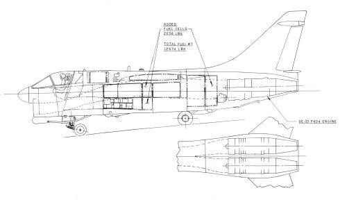

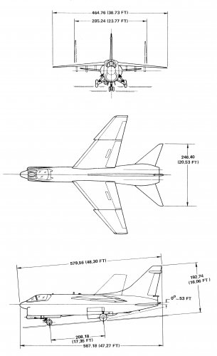

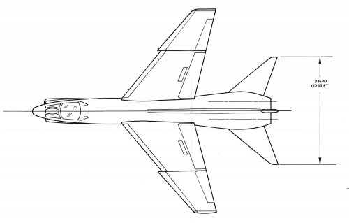

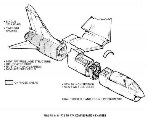

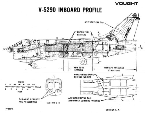

Greetings All -
During the last visit to the Vought Archives, I copied a few drawings of the V-529 from the A-7X development.
Enjoy the Day! Mark
