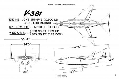

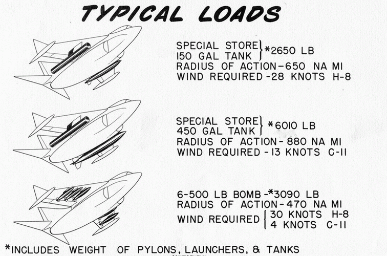

Vought 381, courtesy of what appears to be a collection at the National Archives of George Spangenberg's papers. It was postulated to BuAer as the A3U, the AU being an F4U variant and the A2U, derived from the F7U. It was another attempt at variable geometry. The wing tips could be tilted in flight to increase/decrease the aspect ratio/wing area as desired. More later.

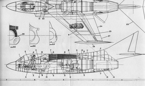

Have to say, the fuselage looks very Grumman-like...
cheers,
Robin.

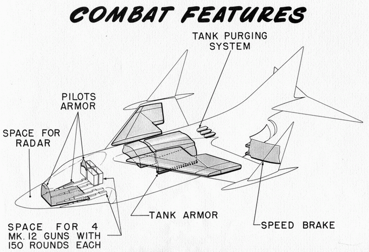

For your viewing pleasure I am attaching a photo of the V-381 exploded view drawing from NARA II Spangenberg-Proposals files.
bill
