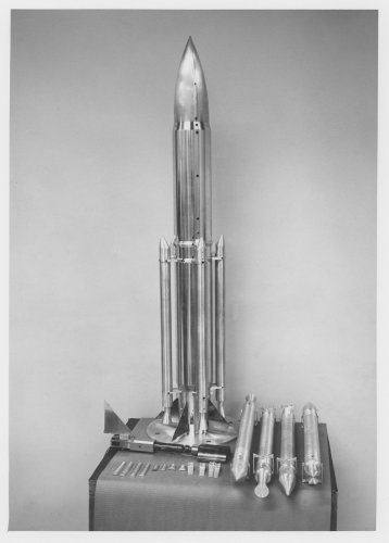

Good Day All!
From the Vought Archives - any idea what this is?
NOTE - SUBJECT CHANGED TO REFLECT IDENTIFICATION OF MODEL
Enjoy the Day! Mark

Reminds me a lot of SA-4. Possibly a threat replication project?

Re: Looking for an ID
Interesting thought...
The fins don't match though and the model's fins have a defined sawtooth in the leading edge and are not just simple shapes.

It is an LTV Scout D first stage with strap-ons and a nose cone. The Scout D is a four stage satellite launcher made up of four different off the shelf motors. The fins are totally Scout and the small transition to a slightly larger diameter of the body just above the fins and just below the upper end of the stage makes it a "D". I'd post pictures I have except they are on a hard drive I have to find.

Thanks Richard - much appreciated! Mark

Well spotted, Richard. Any idea what the purpose was?

When you mentioned SA-4, I too thought it was something Ganef because had I researched that missile and drawn a plan of it to build back in my model rocket days. I didn't look closely enough at the picture until Mark mentioned saw tooth fins and when I looked closer and saw the fin tips and enlargement of the booster, it clicked as a LTV Scout D.
Looking at the picture, they must have wanted something that would lift a big payload fast but not too high. Most Scouts had several stages and this thing seems to be a single stage with strap on kickers to pop it off the pad. It might also be possible that they were exploring the addition of strap-ons to the Scout D to increase its thrust off the pad and the nose cone is a placeholder so they could focus on the interaction of the strap-ons with the booster and later add on the upper stages.
