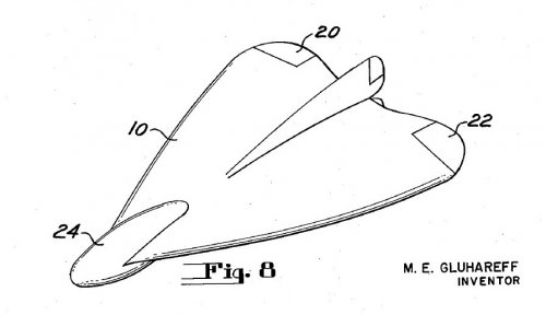

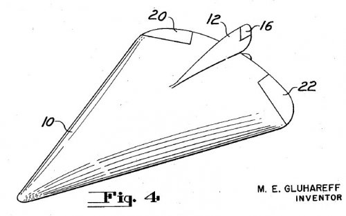

Perhaps the Gluhareff patent n° 2,511,502 filed on June 5, 1946, gives some clues about that missile:
https://docs.google.com/viewer?url=patentimages.storage.googleapis.com/pdfs/US2511502.pdf
"Figs. 1 to 4 show a dart-shaped airplane embodying the invention in the form of a pilotless missile, the flight path of which may be controlled by radio or in any well-known manner usual in the art of guided missiles."
"In Figs. 5 to 8 there is shown a somewhat similar form of guided, missile except that the leading edge of the airfoil-body in the vicinity of the longitudinal axis is provided with a forwardly projecting bulged airfoil body portion (24) of airfoil cross-section which is well pointed at its forward end and which merges-aft into the main
wing airfoil (10). This body (24) may house the control apparatus or in some instances, may
carry the explosive charge of the missile."
