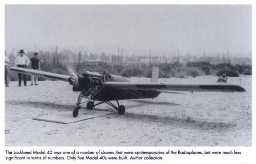

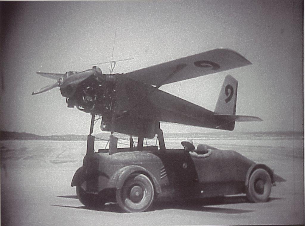

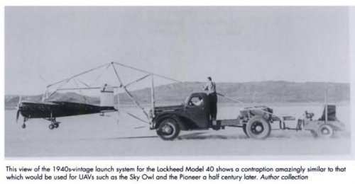

At long last, I have found not one, but two photographs of the elusive Vega Model 40 (also found as the Lockheed Model 40)!
They appear in Attack of the drones: a history of unmanned aerial combat by Bill Yenne, published in 2004.

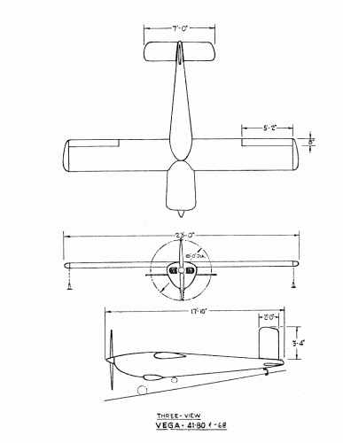

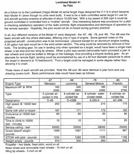

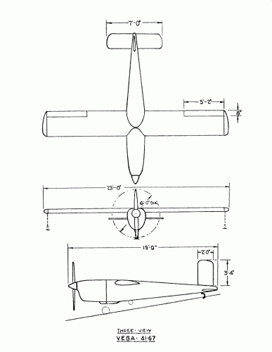

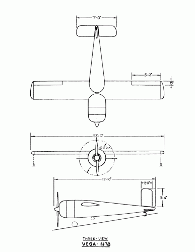

And now that we've finally seen the Model 40, what about the Model 41? Here are three company 3-view drawings for the Models 41-67, 41-78 and 41-80 configurations. None of these was built in the end.
All about the Model 41: http://wmiipms.org/NewsLetters/1995/WMIIPMS_01-1995_NL.pdf

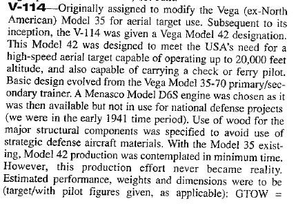

a quote from Journal,American Aviation Historical Society;

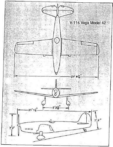

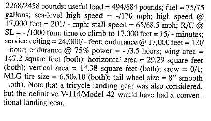

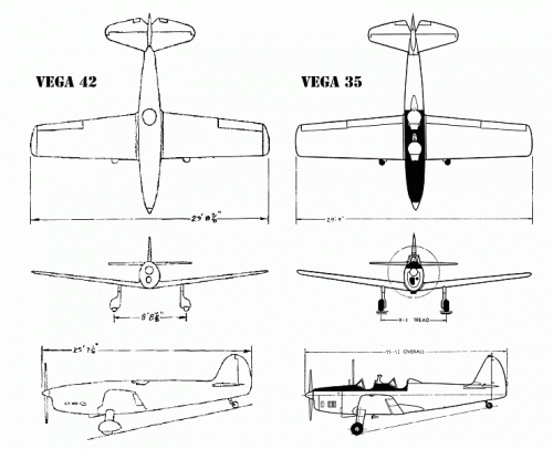

With hesham's find, we have solved the triple mystery of Vega's models 40, 41 and 42 in one single day! Wow.
And what's more, the whole thing is becoming more and more interesting. Indeed, the Vega 42 is simply an unmanned version of the Vega 35 trainer (formerly the North American NA-35). Apart from the shape of the fin, and the type of landing gear, everything is the same!
Also, note how the place normally allocated to the pilot has been glazed on the Model 42. We may well be here in the presence of the very first OPV design ever!
Added text block from http://home.comcast.net/~wmiipms/NewsLetters/1995/WMIIPMS_01-1995_NL.pdf

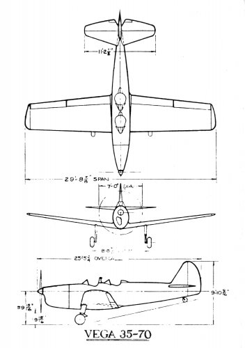

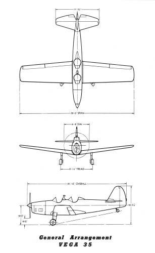

Good Day All -
A couple of Model 35 3 views to go along with this thread as well....
Courtesy of the Gerald Balzer Collection.
Enjoy the Day! Mark
