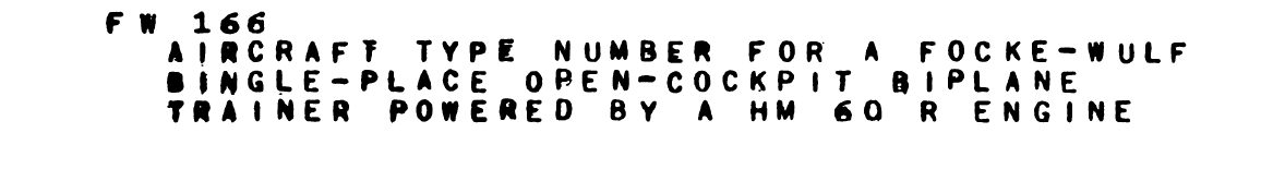

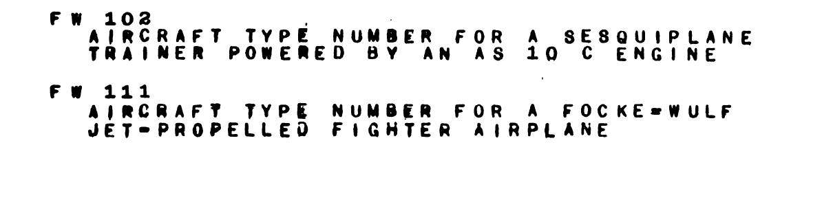

Can anybody tell me what are these projects (FW 111 & 166)?.

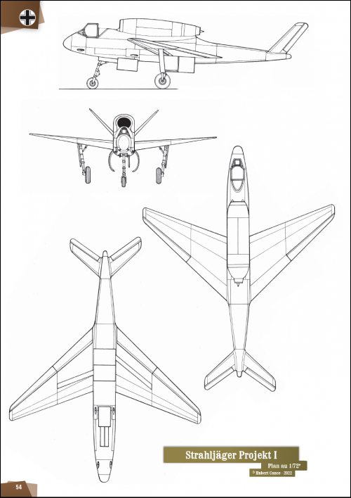

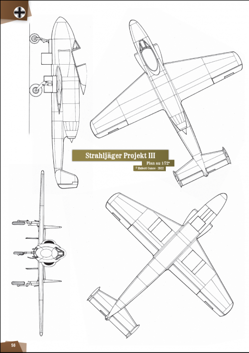

Fw 102 = Misidentified Albatros Al 102 (L 102); 1 x 240 hp Argus As 10C; span 13.30 m.
Fw 111 = Misidentified Focke Wulf Fw P.III (not '111') single-jet fighter project; span 8.20 m
Fw 166 - No such animal. Obviously the authors had never heard of the Flugzeugbau Kiel GmbH and mistook Fk 166 for this fictitious 'Fw 166'. The real Fk 166 (D-ETON) was a cantilever biplane which flew in September 1934. As noted for the 'Fw 166' this aircraft was powered by a 80 hp Hirth HM 60 R air-cooled inline. Span was 6.40 m.
The purpose of the Fk 166 was to demonstrate Flugzeugbau Kiel's abilities for the October 1933 Schattenwerk-Programms. Once their competency was established, Flugzeugbau Kiel became an aircraft components maker and designed no further airframes.

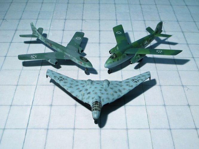

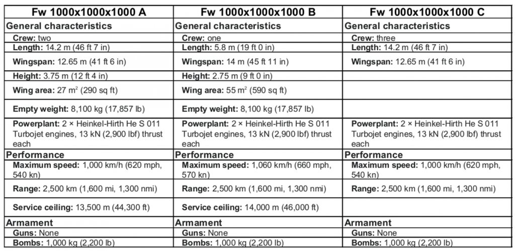

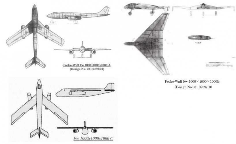

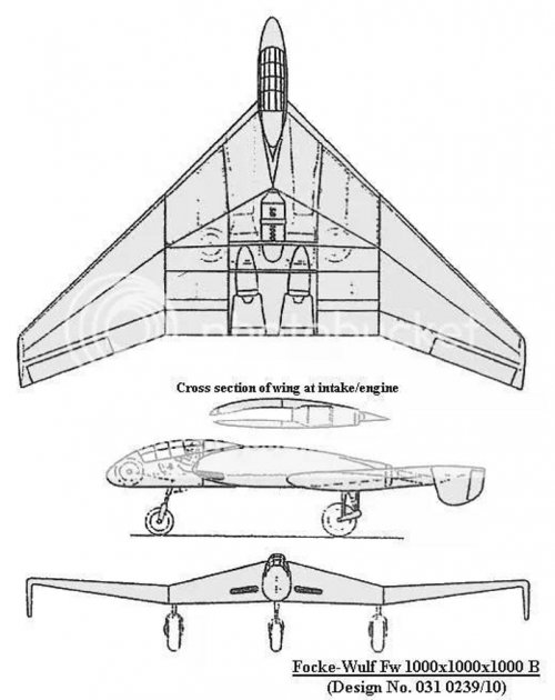

Привет! Источник данных таблицы: Википедия.
Если все данные о пролете верны, то данные типа А и чертеж соответствуют другу другу, но длина типа В, 5,8 м, слишком мала, фактическая длина, по-видимому, составляет 10,2 м.
Длина типа С, составляющая 14,2 м, несколько выше, фактическая длина, по-видимому, составляет 13 м.
https://modelplanes.de/luftwaffe/bo...ocke-wulf-fw-1000x1000x1000-bomber-projekt-c/
