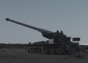

As sport pointed out it appears to be an 8" shell (Much bigger than a 6.1" shell).
Sure looks bigger than 155mm
Though I wish 8” guns would come back into vogue, the hull is marked AGS on multiple areas. That test a few years back had all the prototype and in-service 155mm platforms (M777, M109, ERCA, AGS).

ISSUE with that.
That gun.
What ever Caliber it is.
Is far too THIN to be a 203mm. They are far thicker then that. The Russia 2s7 Pion is a good example of what a modern 203mm gun be like and that is noticeably thicker then the Gun on the M107/110 Chasis. Its closer to the 155mm then it is 203mm size wise, you can see it when it by the Paladins. I can see it being a M113A2 175mm gun, those do have similar profiles, but only Israel uses those after the US Dropped them from the Nam Barrel explosions.
As for change barrels between 127mm and 155mm?
Yeah.. NO.
That is an entire inch of difference between them.
You need to switch out the entire breach system and all the related gear. Cause you will not be fitting a 6 inch wide object into a 5 inch hole.

The original pic posted clearly shows a barrel larger than 155mm.

There are two different apparent muzzle configurations, the one in the vid and the one on the static vehicle. Who knows the configurations and various variable testing occurring.

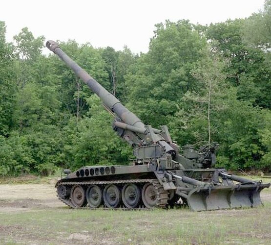

Pretty confident 203mm is dead to the US.
As far as I know the US retired its' M110 8" cannons they are still in service with a number of armies around the world and for example the Turks are currently retiring their M110 units so I won't be surprised if they end up in Ukraine.

Appears to be two different barrels

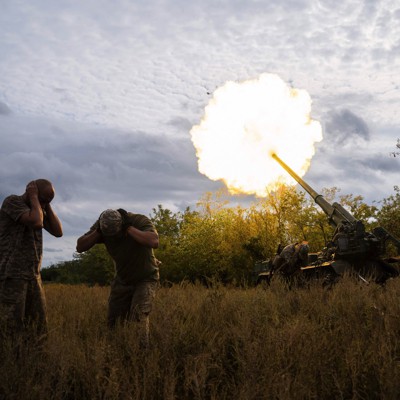

Eight inch shells already have been seen there fired from presumably Pion. I don't think there's any rush to provide additional guns in this caliber given the lack of mobility and very slow rate of fire. Not really sure why there are people who "miss" them; they don't bring anything to the table. The M107 at least brought extreme range, though with a pretty heavy accuracy cost.

Should be remembered that the "Newest" US 8 inch gun was the M110 gun daring to the late 50s early 60s, even the later A2 L37 barrel was just a stretch version of the original L25 barrel. No enlarge chambering or stronger metals for more powder.
But that time they did outrange the 155mms, even the long 50 cal ones, by a good bit.
Issue is that they continue to improve the 155 and not the 203mm. The oldest 155mm in Nato service is from the late 70s mid 80s. As is the M110 203mm was and is still more accurate to it max range of 30km that the 155mms are without PGMs.
If you port over the same modernize from the 155/58 ERCA to the the M110A2 203/37?
The new propellant for the gun and RAP, chamber and shell design, guidence gliding trick, and longer barrel? Say up to a L50 like the WW2 era M1 8 inch gun or the 2S7 Pion?
You will be able to easily hit the 100 kilometer goal of the ERCA with a Rap shell, and be able to double that with the Ramjets.
Edit: also a bigger shell allows you to put more stuff in it. Either it be guidence, RAP fuel, Ramjet fuel More boom, ALL THE ABOVE...
Also will put less stress on the gun itself, the M1299 is suffering from Bore erosion issued from how much ommpht they are trying to get out of it. Some an 8 inch version will not have.
You do know that the AGS gun tube is much thicker in diameter than the Army guns, right? Because it's water cooled.
And Naval guns in general tend to run much thicker barrels for greater heat capacity (taking more rounds fired before the tube is overheated).

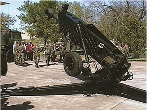

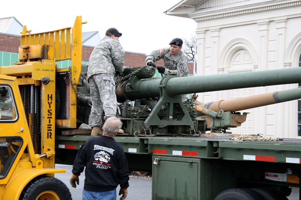

This contemporary test appears large enough to be a 155mm heavy barrel, why use the M-110 chassis if you dont need it?
There are test bed guns out there.
Budget.
The M107/110 chasis is design to be easily switch between the two types, with there originally being a 155mm to go with the 175 and the 203mm guns. That was drop for just since the T55 series fid that just fine.
So its fair cheaper to basically hammer out like...
4 parts to put a 155mm naval gun on.
Compare to custom building a tractor trailer for it.
One is a afternoon and go home early job. The other takes all month.
Plus we have a few thousand of the things in storage.
Also that first gun is not a heavy barrel, and more importantly.
Is on a M198 style mobile firing chasis.
AKA the thing with all the gear to move the gun around in battle. It an actual proper chasis.
The second one looks to be the M777 prototype, which is also on a mobile tow chasis, but with the wheels off.
