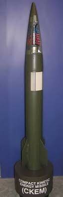

And then replaced that with CKEM - which they also cancelled.
CKEM was closer to being fit to purpose, but still much larger than TOW.
