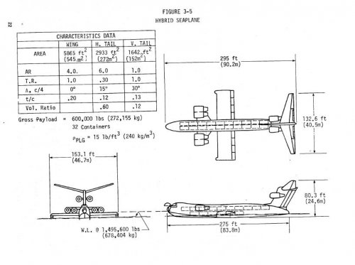

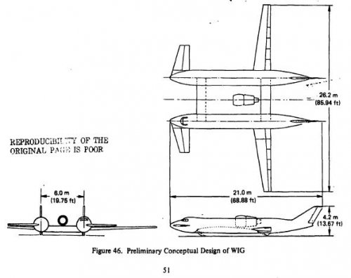

That looks way small for a 250,000 lbs payload...
Even with GE-90s, you would still need more than two engines.
From the look of the cockpit window, this is a much smaller vehicle. My two cents. :)

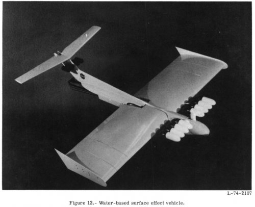

the Bell Air cushion WIG aircraft.
http://ntrs.nasa.gov/archive/nasa/casi.ntrs.nasa.gov/19790017874_1979017874.pdf

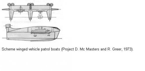

Well, the Navy has the original stealth platform - submarines.
And we had a WIG test program planned in the early '90s. Ran short of money...
V8Interceptor
CLEARANCE: Restricted
Mar 3, 2009
30
0
OM said:
Sorry for ignorant question but why does the USAF have not implemented transport WIG as a mean to storm beaches,
...Because the Air Farce wouldn't be the branch to develop and implement an aircraft for such a purpose. The Navy and Marine Corps would be the most likely branch to consider using such a vehicle, with the Aaaarmy coming in second and most likely using whatever the Navy put into service. That being said, the closest thing the US armed services came to implementing anything WIG was the Sea Spectre, a remarkable cross-breeding between an F-117 and a large PT Boat whose stealthy nature of mission wound up being its reason for failure, as the Navy had extreme difficulties getting any of its flag officers to assume command voluntarily; for some whackjob reason, they felt using such stealth technology combined with stand-off-and-shoot(*) in high seas combat was "cowardly" and "dishonorable". Personally, I'd have given my remaining good leg for the honor of commanding such a vessel. And my left nut for the privilege to actually use its might in combat against our enemies.
(*) If being able to strike from a distance without detection was a sin, try telling that to battlecruisers with 16" guns, painted in camouflage.

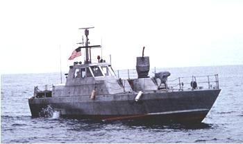

I'm confused? Are you referring to the Navy's MKIII Sea Spectre Patrol Boat? IINM, these had a fairly long service life(mid 70's to late 90's) but were not particularly stealthy so I don't understand the F-117 reference?
I think he was meaning the "Sea Shadow" no the spectre...

Ah, that makes a little more sense, though Sea Shadow is only a technology demonstrator incapable of deploying weapons(and of course, not a WIG)...

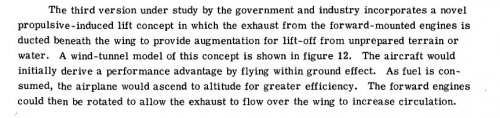

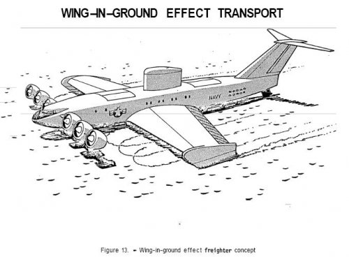

A WIG concept under study by the NASA in 1975
Source: http://ntrs.nasa.gov/archive/nasa/casi.ntrs.nasa.gov/19760005976_1976005976.pdf

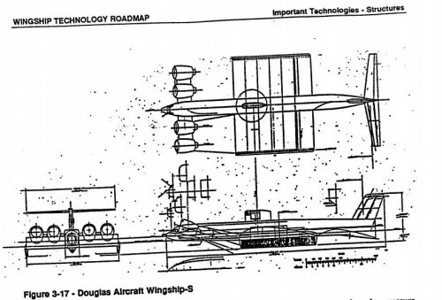

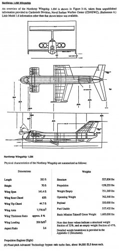

OR... we can try to clean them up a bit to make them a little more user friendly... Don't you think it's a lot better this way?

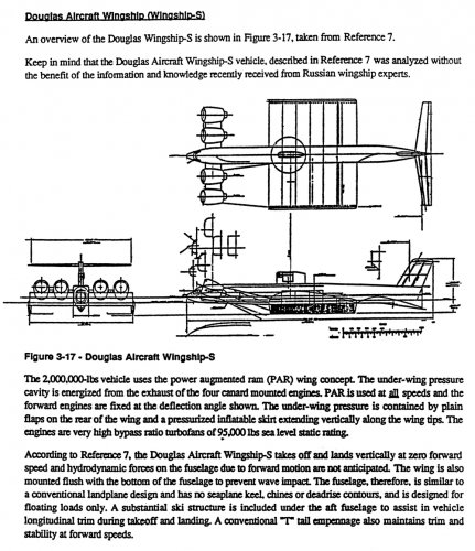

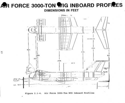

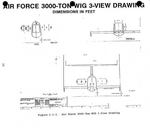

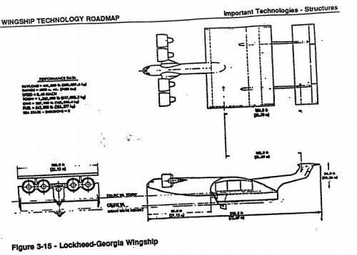

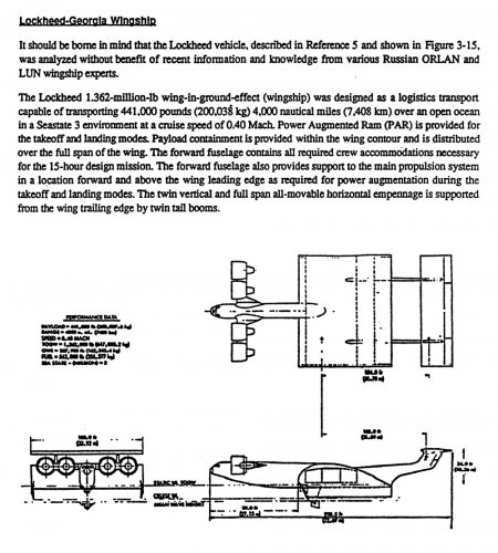

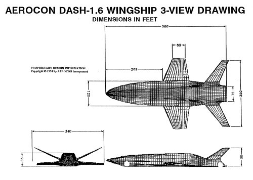

Nice... but if it's the Aerocon design, why does the blueprint say "Northrop"?!?
Stargazer2006
CLEARANCE: Above Top Secret
Jun 25, 2009
13,242
112

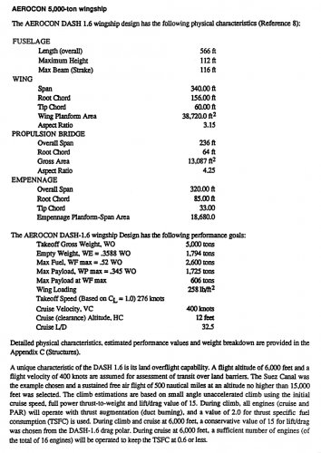

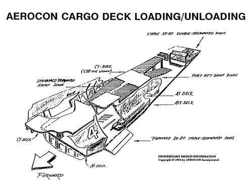

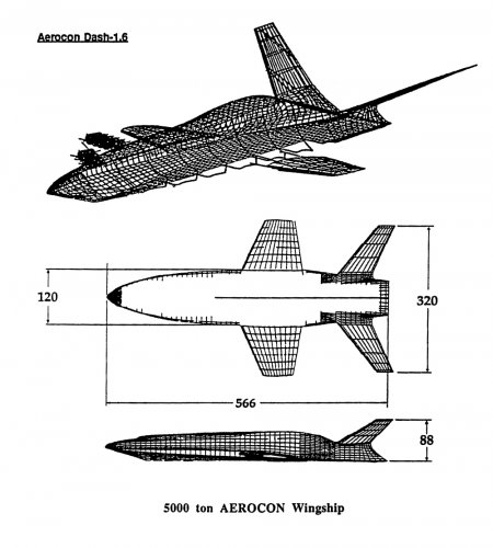

As I suspected, this is not the Aerocon proposal, but a USAF proposal based on a Northrop design (ARPA Wingship Program Parametric Study - Preliminary Results -
Northrop Jul. 1993):
The two WIG concepts evaluated in this study are the DASH-1.6, 5000-ton Wingship created by Aerocon Incorporated, and a 3000-ton variant developed by the Air Force ASC/XREDT of a Northrop 800-ton concept. Details on these two concepts, as provided by their developers (References 2 and 3), are presented below.
The inboard profile drawing, shown earlier in Figure 2.1-4, for the Northrop 800-ton WIG depicts a nose visor door and rear port side doors for loading and unloading. No dimensions are given for these doors. It is assumed that the nose visor door will open completely to provide straight-in loading/unloading access to the full 28.4 ft wide and total 33+ ft high (14 ft upper, 19 ft lower, plus upper floor thickness) cargo compartment. The two rear loading doors appear to give full height access; the total width of the two doors appears to be about 60-percent greater than the height.
No ramps or other equipment are shown in the drawings for loading and unloading. Integral ramps, similar to those on the Aerocon concept, could be developed as a future design refinement.

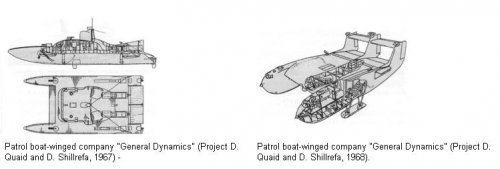

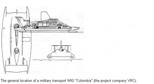

in 1961,the Office of Naval Operations Staff of the US. Navy had decided to make a
competition for design of Large Military Transport Amphibian aircraft,the competition
was attended by several US companies,but the winner was VRC Colombia.

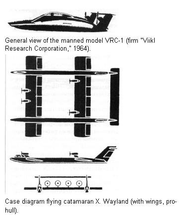

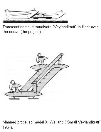

Before objection,please see the Translation;
Specialists MIT long worked to create the winged, which is a hybrid aircraft and ocean-going vessel.Finally, in 1995, they announced their project improved WIG W1GM.WIG, received the name «Fastship» (speed ship), be equipped jet engines on aircraft «Boeing-747".W1GM combined the possibility of obtaining a high flight speed and aerodynamic efficiency when driving in the zone of influence of ground effect, and outside of it.At higher altitudes the winged flight was designed to achieve transonic speeds.Power plant included turbojets general thrust 203 tons.

The only thing I learn from this very approximate piece of English is that they used 747 engines.
Hardly makes it a Boeing 747 variant, does it?
Also you misread the General Dynamics project as having a "Project D" designation... It doesn't. The "D" is the initial of the first designer.

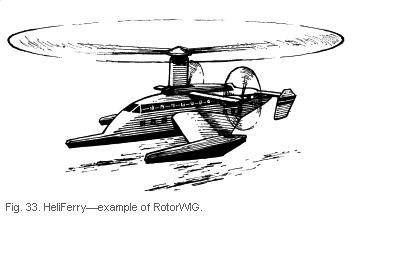

here is the HeliFerry,a WIG helicopter concept.
http://www.sciencedirect.com/science/article/pii/S0376042106000637
