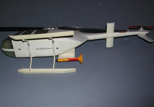

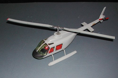

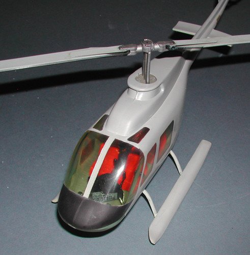

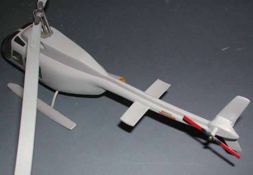

Bell H-57 Sea Ranger-based ASW helicopter (US Navy LAMPS) model manufactured by Rolen found on eBay.
URL:
http://www.ebay.com/itm/ROLEN-NAVY-BELL-H-57-SEA-RANGER-ASW-FACTORY-HELICOPTER-DESK-MODEL-TOPPING-/400420295386?pt=LH_DefaultDomain_0&hash=item5d3ae8d2da
Seller's description:
ROLEN Bell H-57 SEA RANGER factory ASW proposal model. Not sure of the history of this proposal but this H-57 model features a non standard sono-bouy. Model is in excellent overall condition. Nice main and tail rotor. Looks to be missing some kind of a centerline pod, tank or weapon. The instrument console has broken loose inside the cockpit. Fuselage length 12" with a 13" rotor span.

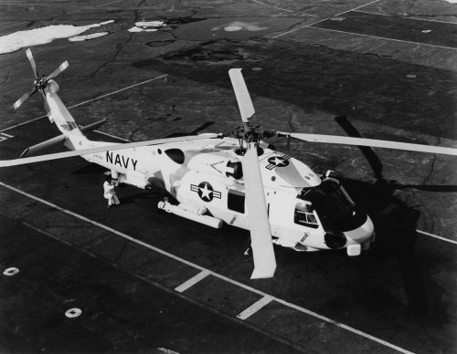

Sikorsky's winning design in full-scale mockup form (photo from the cover of Aviation Week, April 3, 1978):

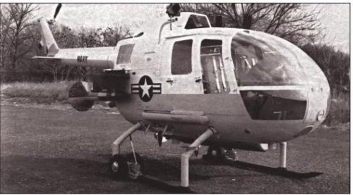

Found in VertiFlite, August 1969, two artist impressions of the BO 105 LAMPS proposal:
Do you know from the article if this submittal was made directly by Bölkow or was it done by Boeing Vertol?
I think, the answer in the mentioned article is "..The hingeless-rotor BO-105 will be demonstrated initially in the
U. S. as a LAMPS competitor — this tour marking the first milestone in a marketing program since Boeing and
the West German firm of Messerschmitt-Boelkow-Blohm completed a licensing and marketing agreement. "
I remember reading, that Boeing got also to use MBB's patents and technologies for their own projects and products. The hingeless rotor system for example was used for Boeing's helicopter projects.

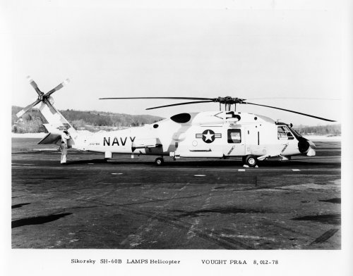

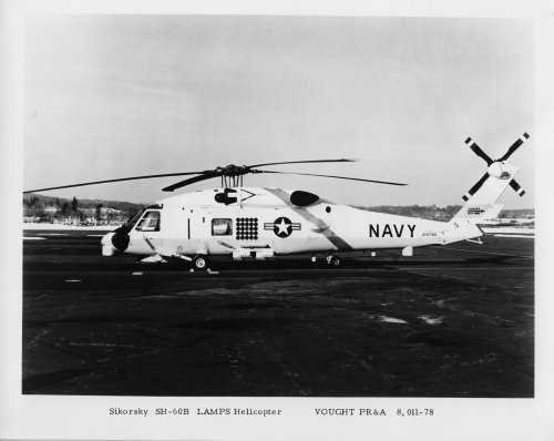

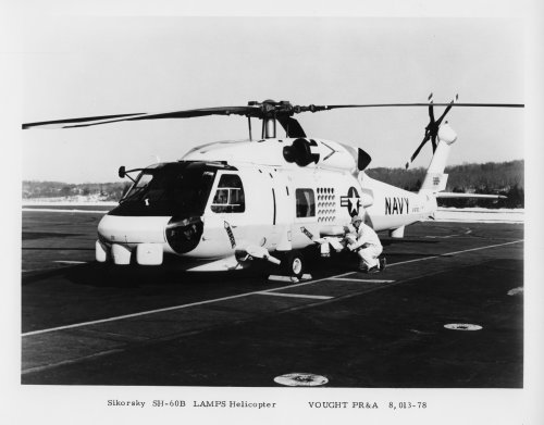

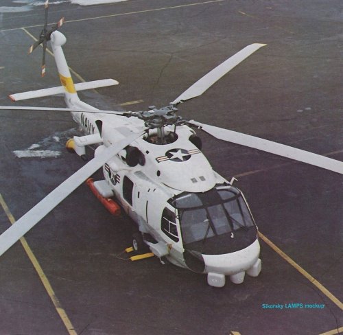

Good Day All -
Photos of the Sikorsky SH-60B mock up and a couple of artworks courtesy of the Vought Archives.
Enjoy the Day! Mark

Mark Nankivil said:
Good Day All -
Enjoy the Day! Mark
So going by the above post Mark Nankivil, did Vought/LTV have an affiliation with Sikorsky in terms of the SH-60B? Hence it being in the Vought Archives?
Regards
Pioneer

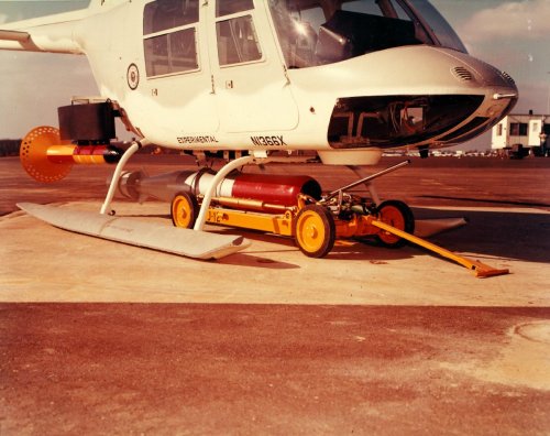

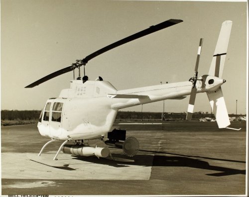

Here is a link to footage of Bell's JetRanger-based LASH proposal demonstrator, N1366X, posted at the University of North Texas Digital Library in their Bell Aircraft / Bell Helicopter collection.
https://digital.library.unt.edu/ark:/67531/metadc2576786/m1/
The titles/information provided by Bell with respect to the silent footage is listed as:
  • Main Title: MAD Gear, Light Anti-Submarine Helicopter
  • Added Title: BT-403: Lash 3057-403 Reshoot of Mad Gear, Light Anti-Submarine Helicopter, Orig. Color
The footage shows the helicopter trailing a MAD "bird", while carrying a mock-up torpedo under its fuselage. Additional footage shows the fitting of in-field work stands and the manual folding of the two-bladed rotor, as well as the aircraft being fitted with a couple of MEDEVAC stretchers along the port side of the cabin.
