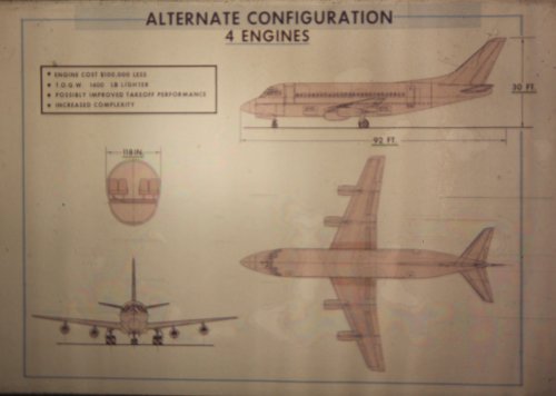

Finally, North American. Even more so than Martin, that company focused mostly on military contracts, but they did have an airliner project called the NAC-100 Centuryliner,. It was a twin-jet, but an alternate four-jet configuration existed. Still it was an aircraft of smaller size than the 707 and DC-8 types, for a maximum of 60 passengers.
