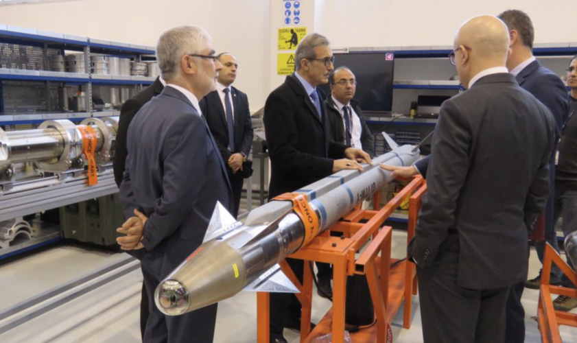

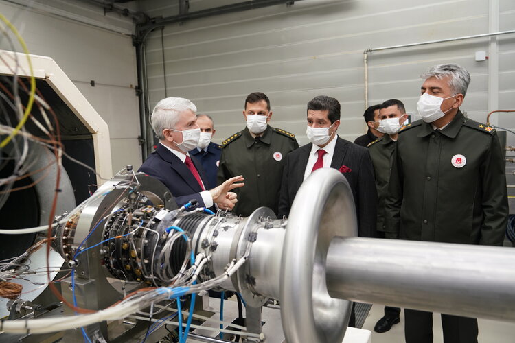

The General Manager of Military Factories Imdat Ersoy and the accompanying delegation visited our Eskişehir Campus. They received information from Mahmut F. Akşit about our projects and discussed potential collaborations.

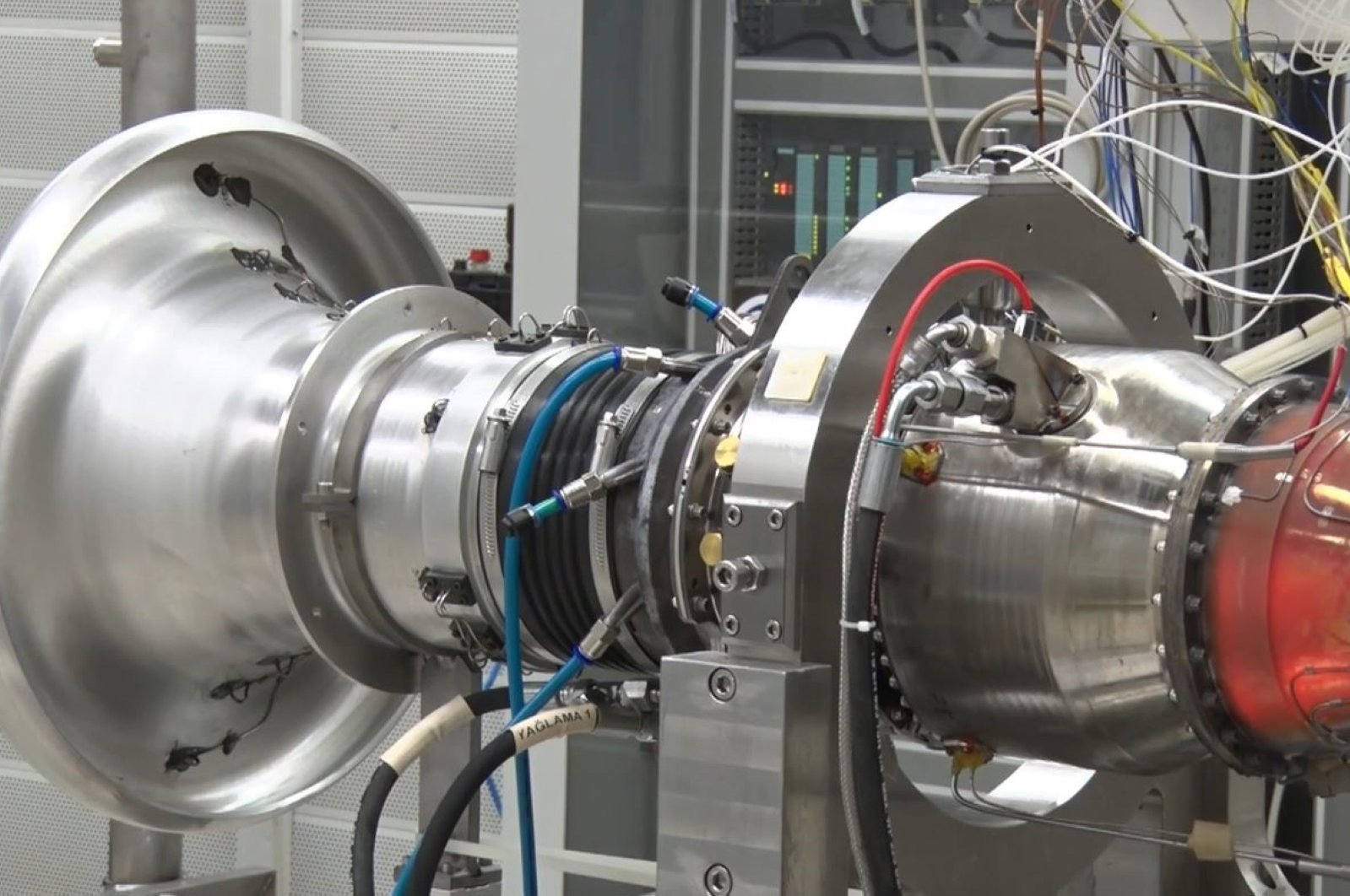

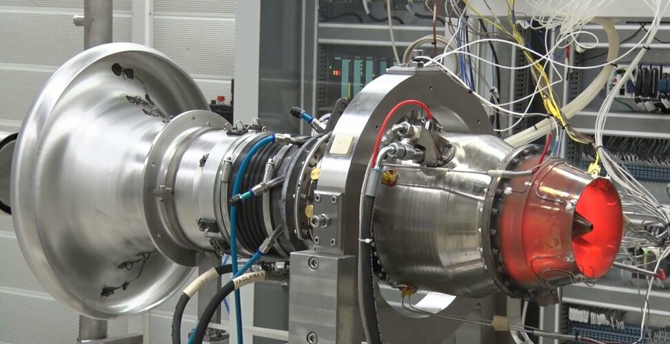

TEI-TJ300 Medium Range Anti-Ship Missile Engine in test cell
TEI-TJ300 is the first engine in the world to produce power in the specified thrust class within a limited diameter of 240 mm, for adaptation to missile systems. The strictly constrained engine size allows its prospective missile systems to fit into multiple platforms. The TEI-TJ300 engine is capable of operating at high speeds of up to 90% speed of sound at an altitude of 5000 ft. The engine also has the capability to start by windmilling without the need for any starter systems (e.g starter motor), which enables the platform to be applicable to air, marine and land based defense systems.
Technical Specifications​
  • Maximum Thrust (N)/(lbf) : 1300/300
  • Specific Fuel Consumption (g/kN.s) : 37.4 (SLS ISA0, excluding lubrication requirement)
  • Dry Weight (kg)/(lb) : 34/74.9
  • Length (mm)/(in) : 450/17.7
  • Diameter (mm)/(in) : 240/9.5

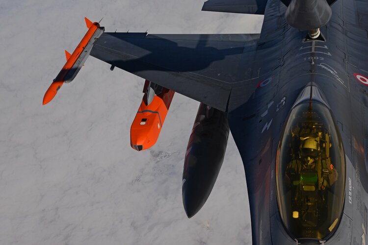

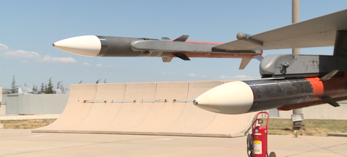

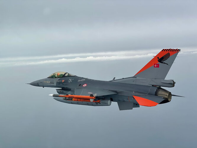

Testing has commenced with live Bozdoğan (Merlin) WVR air to air missile. Also, you can see Gökdoğan (Peregrine) BVR missile on the wing tip pylons.
Turkey's indigenous BOZDOGAN Within Visual Range (WVR) Air-to-Air Missile Successfully Hit the Target in the Its First Aircraft Launched Test Firing
Weight: 140kg (308 pounds)
Length: 3.3 meters (10feet 8inches)
Diameter: 160mm (6.3inch)
Speed: 4+ mach
Seeker Range: 25km

Turkey’s 1st local medium-range missile engine breaks world record, with an outer diameter of 240mm TEI-TJ300 produced 1,342N of thrust - TEI aiming to further increase performance to 1,400N of thrust.
https://www.dailysabah.com/business...dium-range-missile-engine-breaks-world-record
TEI-TJ300 is being developed for Turkey's Medium Range Anti-Ship Missile, which will eventually phase out Penguin missiles.

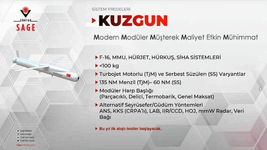

KUZGUN Modern Modular Joint Attack Missile
Platforms; F-16, Hurjet, Hurkus, TFX and UCAVs
Weight; <100kg
Propulsion Configurations; TJM (Turbojet engine) and SS (Free-Fall Glide)
Range; 135nm (250km) for TJM Variant and 60nm (110km) for SS Variant
Warhead Configurations; Pre-Fragmentated, Penetrating, Thermobaric or General High Explosive Variants
Guidance Configurations; INS (Inertial Navigation) GNS (Global Navigations System) SAL (Semi-Active Laser) IIR/CCD (Thermal/Day Camera) MMW Radar and Data-Link
Live firing tests to start this year.

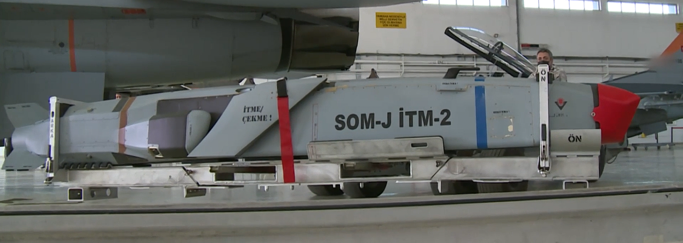

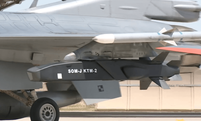

SOM-J Missile
SOM-J is the variant of the SOM Missile System Family specially designed for F-35 Joint Strike Fighter (JSF) internal/external carriage and used against highly defended, anti-access and high value stationary ground and moving maritime targets.
• Missile Weight ~1100 lb. (500 kg)
• Semi-Armor Piercing Warhead
• Global Positioning System (GPS)
• Inertial Navigation System (INS)
• Terrain Referenced Navigation (TRN)
• Imaging Infra-Red (IIR) Seeker
• Automatic Target Acquisition (ATA)
• Network Enabled Weapon (NEW) Capability
• Universal Armament Interface (UAI) Compatibility
• Off-Board, On-Board and In-Flight Mission Planning Capability

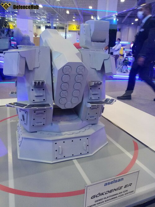

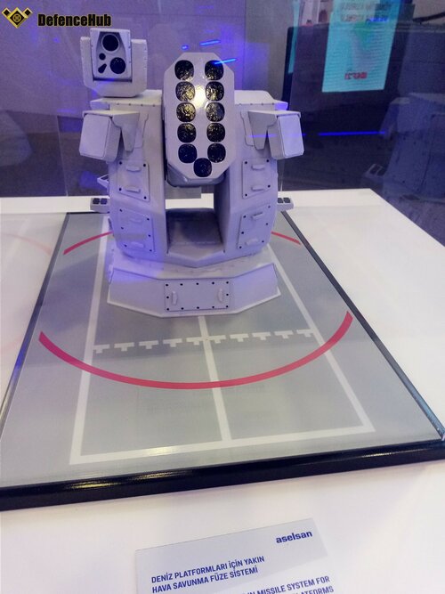

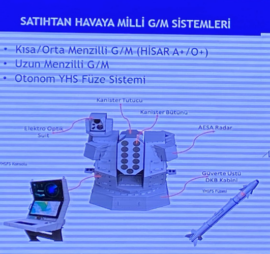

21-cell Levent Rolling Airframe Missile system for Naval Point Defence is in development. The point defence missiles will be based on the SUNGUR and will have different variants and engagement ranges that the operator can select from. There will also be a standalone variant similar to SeaRAM.
Will further update this post when more information is available.

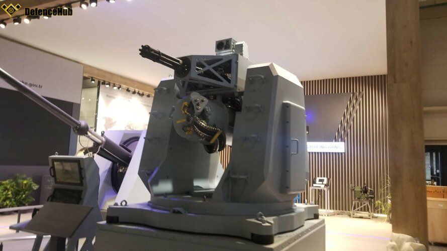

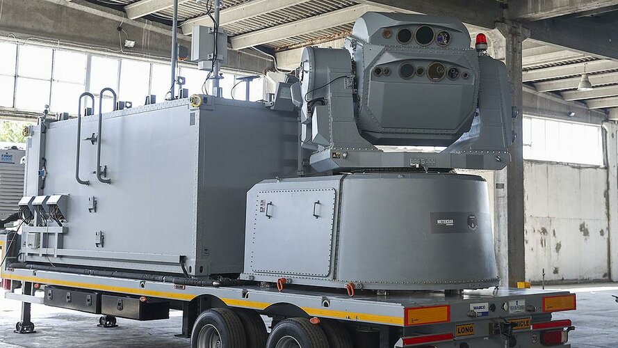

MKE of Turkey is developing CIWS which is almost identical to Phalanx CIWS. Sea and Land-based versions for point defence will be developed. This variant is fitted with E/O targeting system, AESA multi-function radar is in the works to provide search, tracking and targeting.
Turkey's Vertical Launch System developed by Roketsan is continuing in line with the construction of the Istanbul Class Frigate.
These developments began in akin to US weapons embargo of MK-41 VLS, RIM-116 Rolling Airframe Missile and Phalanx CIWS

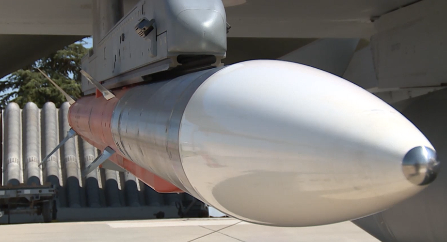

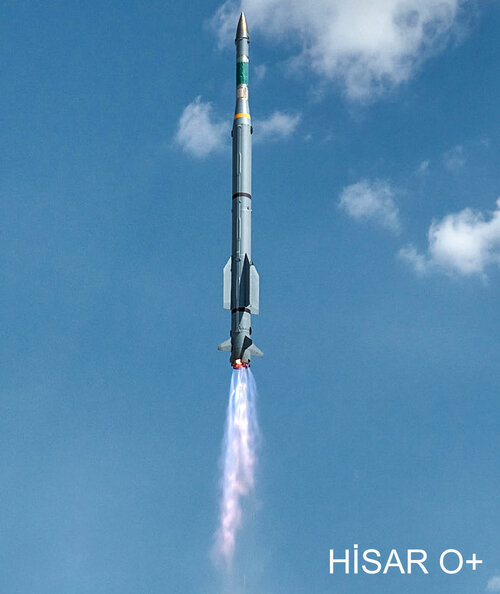

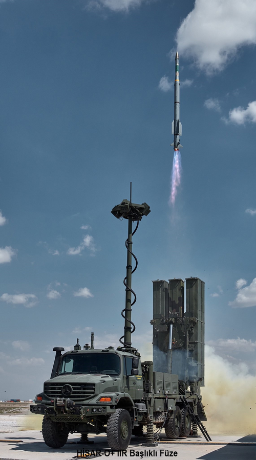

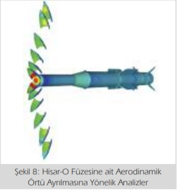

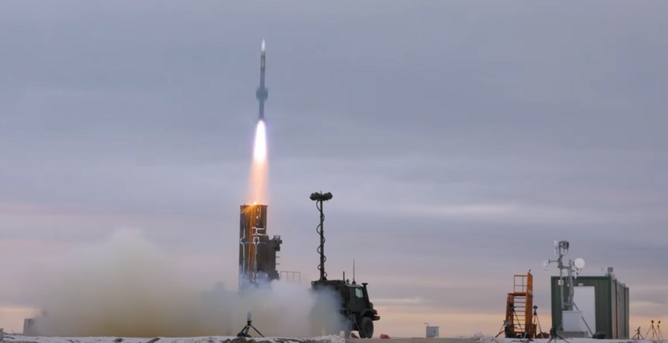

HISAR O+ medium-altitude Anti-Air Missile is in serial production
This is an IIR seeker missile, the cone separates as the missile gets closer to the target.

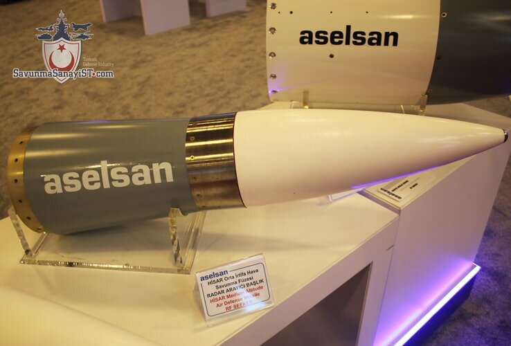

An Active R/F seeker variant is currently in development

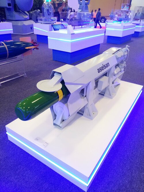

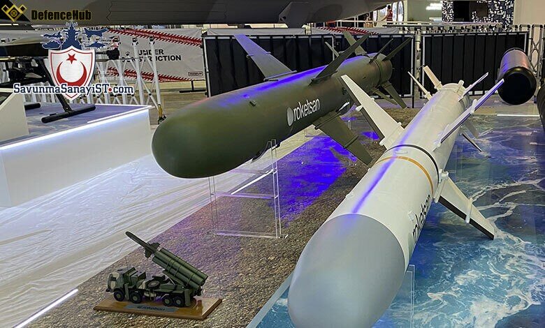

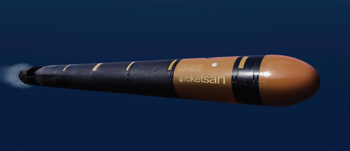

Roketsan's AKYA heavyweight Torpedo will enter service towards the end of this year. Stated to have 50+km max range and a 45+ knot max speed.

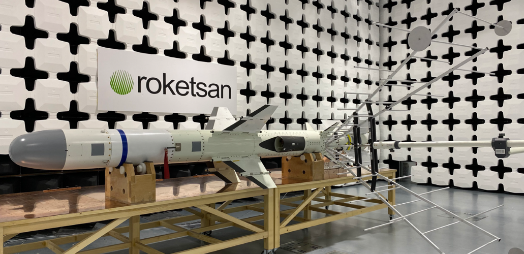

ATMACA Surface to Surface Cruise Missile is in development.
Next to ATMACA AShM
Signing ceremony for Land Attack Version of Atmaca Cruise Missile. This means it's actually happening, Turkish land forces will get precision strike capability out to 280km.

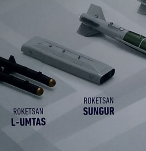

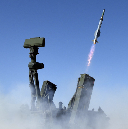

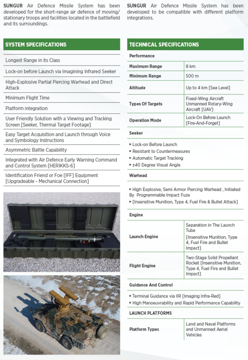

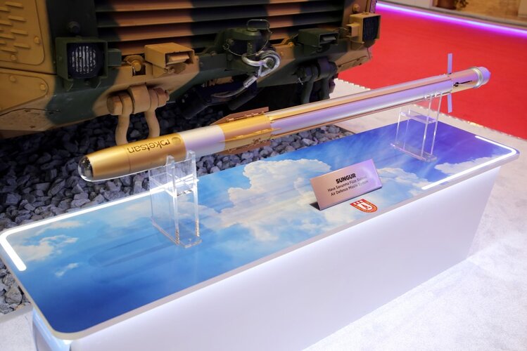

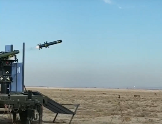

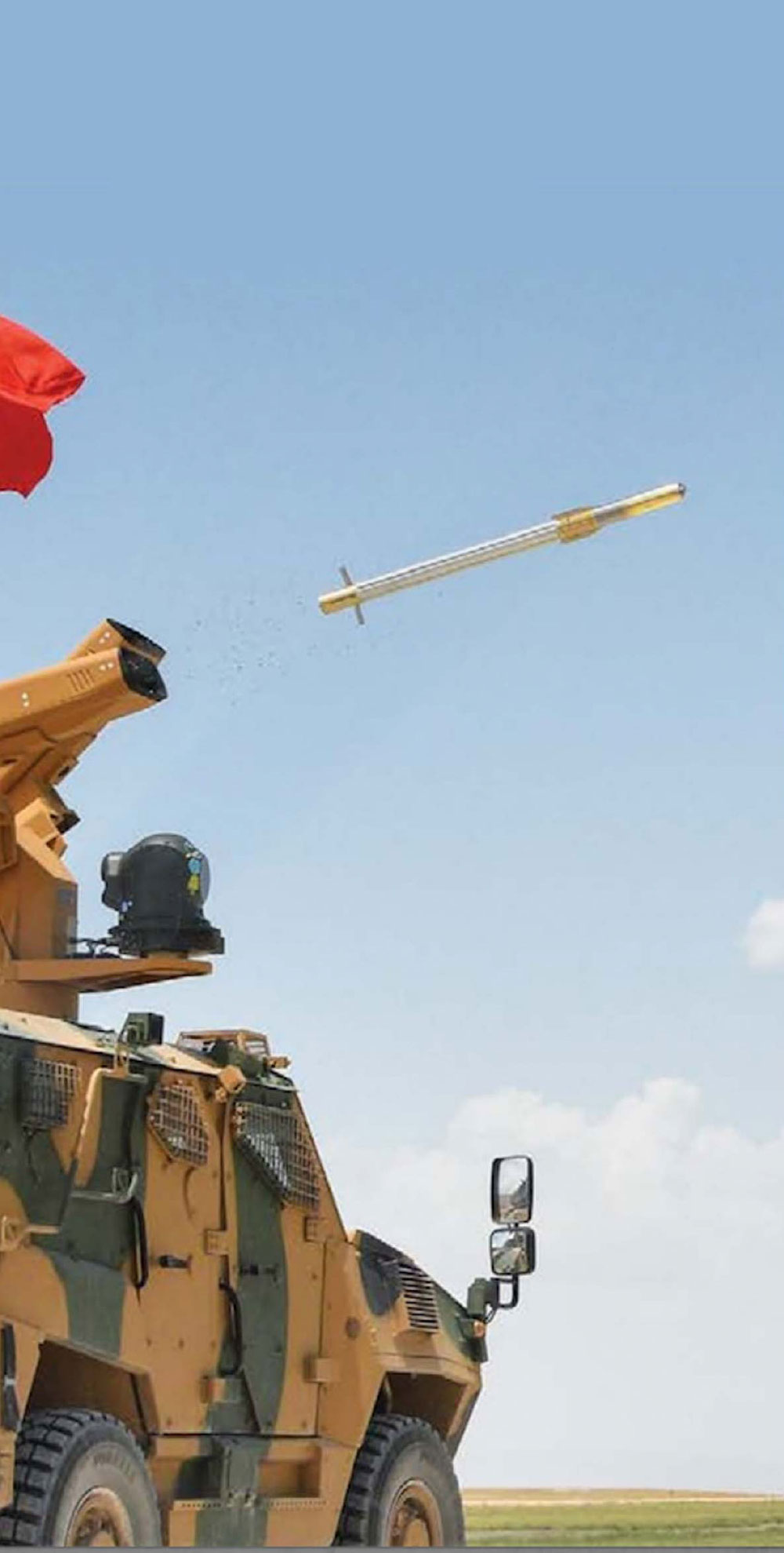

SUNGUR VSHORAD
250 missiles will be delivered this year, some to be integrated on vehicular launchers and some as MANPADs.
2 x Sungur launcher for Fixed and Rotary wing aircraft

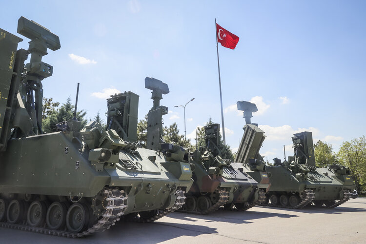

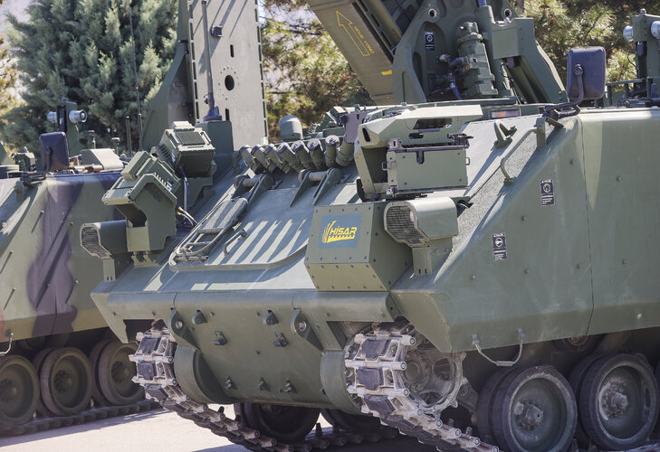

HISAR Air Defence Missile System will be capable of launching 3 types of missile loads;
*Hisar-A+ (Short-Range) image infrared (IIR) seeker-head missile
*Hisar-O+ (Medium-Range) image infrared (IIR) seeker-head missile
*Hisar-O+ (Medium-Range) active radar (RF) seeker-head missile
