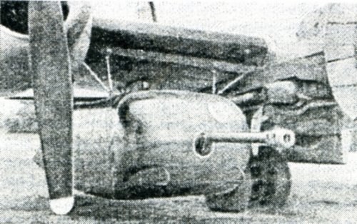

TU-4D ("izdeliye 76) 1951-54 / Military Transport Aviation fitted for transporting and dropping with parachute 28 paratroopers(each of them had simple breathing device connected to the aircraft oxygen system), are placed with a minimum of comfort in the forward bombbay. As well as military equipment in the cabs suspended under the wing type P-90, P-98 and P-85 containers.
Tu-4T ("4T") 1955 / Further modification of the Tu-4D. The number of troopers increased to 40-46 people. (Later the number of seats has been brought up to 52) on the external suspension could carry: two self-propelled artillery system ASU-57 or BTR-40 armored cars, gun up to 85mm, other military goods to 6000kg.
