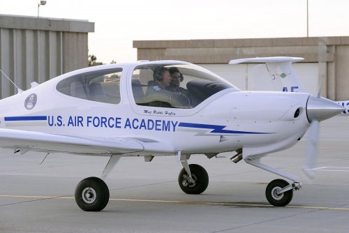

On a sidenote, the USAF also uses six civil registered Diamond DA-20C-1 Falcon as USAF Academy trainers at Embry-Riddle Aero University, which are custom Eclipse/Evolution derivatives.

The USAF Academy also used the Diamond DA-40 under the designation T-52A.
