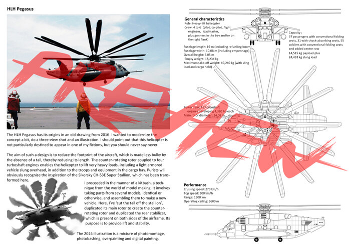

The HLH Pegasus has its origins in an old drawing from 2016. I wanted to modernize the concept a bit, do a three-view shot and an illustration. I should point out that this helicopter is not particularly destined to appear in one of my fictions, but you should never say never.
The aim of such a design is to reduce the footprint of the aircraft, which is made less bulky by the absence of a tail, thereby reducing its length. The counter-rotating rotor coupled to four turboshaft engines enables the helicopter to lift very heavy loads, including a light armored vehicle slung overhead, in addition to the troops and equipment in the cargo bay. Purists will obviously recognize the inspiration of the Sikorsky CH-53E Super Stallion, which has been transformed here.
I proceeded in the manner of a kitbash, a technique from the world of model making. It involves taking parts from several models, identical or otherwise, and assembling them to make a new vehicle. Here, I’ve ‘cut the tail off the stallion’, duplicated its main rotor to create the counter-rotating rotor and duplicated the rear stabilizer, which is present on both sides of the airframe. Its purpose is to provide lift and stability.
The 2024 illustration is a mixture of photomontage, photobashing, overpainting and digital painting.

Noted. If you can give me more technical details, it would help me to make more realistic design in the future.
It really depends on the type of coaxial rotor.system you want to use. There is the tried and true Kamov soft inplane system, or you could go with the new(er) Sikorsky ridged rotor, that they have been trying to perfect with the X2. If you are looking for realistic, I would go with Kamov, as their transmission I relatively flat. X2 is larger and would likely consume much of the cargo space. Alternately, you could hypothesize that Sikorsky perrfects the technology and are able to build a smaller transmission. Either way there are plenty of pictures of the two systems to design from.
If you are looking for more realism, I would say that your loosing the tailboom of the CH-53 radically changes the center of gravity well forward. This would necessitate moving the rotorsystem forward to retain it at the center of gravity. Conversely, to keep things in order, yo might consider putting a couple of ducted fans on the tail end to keep the weight consistent. This would also give you a propulser that can improve acceleration/deceleration, as well giving you a higher cruise speed.
Hope this is what you are looking for.
Thank you. Yes, it helped me. I learned a few think that will be useful ;)

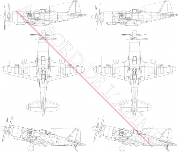

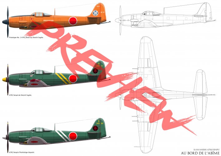

Here is a post-war IJN fighter from my Alternate History novels "At the Edge of the Abyss" volume 2: The Kawanishi A7K2 Senpū.
A long time without any post on this topic.
Kawanishi A7K Senpu
The chapter presenting the A7K has been posted on my side, with cleaned artwork.
You can find the chapter here, as well as some bonus illustrations here.
Mitsubishi A8M2b Arawashi and A8M2-J Raiu
It was followed by the post of the A8M (still in "Au Bord de l'Abîme"), with a cleaned design and totally remade illustration (finally satisfied with it).
