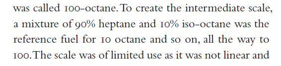

According to the errata list on your website you made following change for next printing:
page 25, “90% Iso-Octane” should be “90% Heptane”
I suggest you change 90 % iso-octane into 10 % iso-octane (as I mentioned before), not into 90 % heptane, otherwise the whole sentence makes no sense as it would contain the word heptane twice. Reread the whole sentence.
Moreover the octane scale is based on the iso-octane concentration in heptane, not on the (100 minus iso-octane concentration) heptane concentration.
What is the latest deadline for suggestions for the 3rd printing?
The errata is just showing roughly whats changed (I`ve now added the full sentence itself to the errata), the actual passage in the 3rd printing will read:
The deadline for typo`s correction is tomorrow afternoon (i.e. Monday 25th Jan).

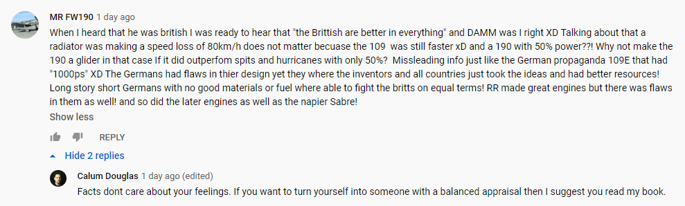

"wonderwaffe" "napkinwaffe" Oh the thrill of putting down the Jerries... I strongly suspect that if the situation was turned around and the British faced the same situation as existed in Germany then we would hear nothing but "the heroic efforts" of all involved. Perspective is important.
In 1940 the situation was pretty dire for the British. They kept their heads and applied their efforts where it was most effective (e.g. develop the Merlin) instead of spending countless engineering hours on wunderwaffen. In many aspects of the war, the Germans squandered what advantage they had by chasing dead ends.
So let's not reduce the rather glaring difference between the Germans and pretty much all of the Allies to just perspective.
You have provided no new information. None. Your bias is based on a lack of information. And I was not referring to all of the Allies, just the British. The Germans had fuel injection early on, the British did not.
I was not putting down the Germans.
I was referring to the absurd post-war fascination with Luft 46 jets with 1950s aerodynamics, missile technologies, Type XXI U-boats, Maus tanks, legions of troops with Sturmgewhers - all super war turning weapons that could have beat the Allies so the revisionist story goes.
All these fantasies have no root in reality when you look at the dire condition of the German war economy and the supply situation. They were at best a handful of barely completed prototypes, there was a serious shortage of metals and alloys, oils, plastics, trained manpower etc. that prevented maximum performance and would have caused serious production problems.
There was nothing wrong with German engineering ability. Its wrong to suggest either side was better than the other in engineering prowess. In some areas one side held an advantage but were weaker in others. Production and raw materials is a different matter entirely.
Look at the book, sparrmetals already in use before war even began to save stocks of key materals, serious fuel quality problems and very small stocks of high-octane fuel throughout the war. By 1945 even methanol for boosting was out of stock.
From the sources in the book it seems that even despite the Battle of the Atlantic and shipping losses that British engine manufacturers never lacked the alloys they needed or worried about it. Their high octane plants were never bombed and fuel stocks never ran dangerously low despite operating a far more fuel-thirsty strategic bombing fleet.
The Luftwaffe did great feats with what it had, probably performing better than it should have during the early part of the war. That should not be forgotten, but in a war of attrition the balance firmly favoured the Allies.
The designer can design the perfect mechanical object but if its built from sub-standard materials and run by poor qaulity fuel and operated by a minimally-trained pilot/driver/crew then the designer's performance dreams will never be realised.
