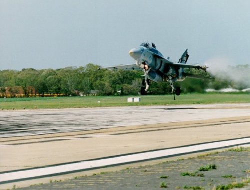

By the way, one result of vulnerability specs has been some remarkably tough aircraft (see photo); clearly this isn't weapon damage, but redundant systems, routing and check valves all play a part.
So basically, "uhm, we're using a different yard stick against the Harrier".
"F-35 LFT&E, with which the DOT&E is concerned, is about showing that the F-35 meets the vulnerability requirement that the contractor signed up to meet. "
Is there evidence to show that it doesn't? Or will you have a tizzy when they find out they need to make some tweaks to meet it? (You know, like they did with the F-22's wing spars?)
"By the way, one result of vulnerability specs has been some remarkably tough aircraft (see photo); clearly this isn't weapon damage, but redundant systems, routing and check valves all play a part."
I wonder what would happen to a Harrier with that kind of damage. (Or a Typhoon for that matter.)
I wonder if a Typhoon could make it back to a safe landing with this kind of damage:
No? Whoa, you mean the Typhoon is worse than the 40 year old F-15? You guys are getting ripped off.
That's a roundabout way of saying an F-35B is more vulnerable than an F-15 or F-18. No, I don't know how Typhoon will stand up to damage, but that's just you changing the subject, isn't it? Got something to hide?

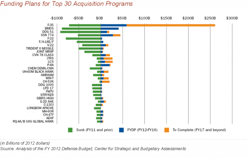

As for "obsession" with the F-35, there are 250-billion-plus reasons to focus on it.
