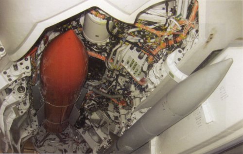

Nice pic of F-35 weapons bay from Aviation International News July 17th (Farnborough)
I am just thinking about if it is necessary to have all that stuff, cables and equipment inside... For the first time it looked to me as a junkyard. I hope it is only test equipment in pre-production machines.
I think part of the reason you see that (the F-22 is the same) is because they are also convenient access points for maintenance and repair.
That and there's a fair bit of actuated equipment, that needs linking into the aircraft's "nervous system", in each weapons bay (the weapons do swing out to clear the fuselage). I can assure you, from experience, that there's not a lot of wasted volume on board.
*chuckle* On the other hand, I can just go down to the plant floor or out to the flightline (and I've done that on some problem resolution efforts - got kudos for a timely resolution, too) and get "up close and personal with one. THen again, I'm also a designer on that program. Some very nice and advanced bits of equipment going into this one.
The fit on the F-35A? I'll agree that it's not that aesthetically-pleasing, but the shapes were determined more by low observables and aerodynamics than by aesthetics. The gun that's an optional fit to the F-35B and F-35C is a podded affair that's not totally aesthetically-pleasing either.

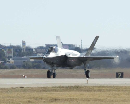

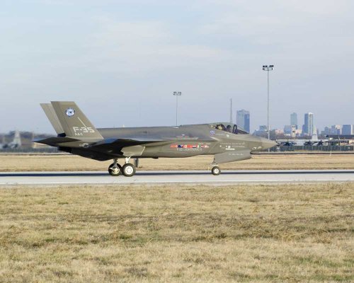

LOCKHEED MARTIN F-35 COMPLETES FIRST GROUND TAXI TEST
FORT WORTH, Texas , December 8, 2006 --
The F-35 Lightning II moved under its own power for the first time on Thursday afternoon, initiating the last series of tests before the fighter jet’s first flight.
The first F-35 Lightning II taxis along the runway at Lockheed Martin in Fort Worth, Texas, on Dec. 7. The test initiated the last round of evaluations before the jet's first flight, and marked the first time the aircraft moved under its own power.
F-35 Lightning II taxis along the runway (JPG, 4.78 MB High-Resolution Photo)
http://www.lockheedmartin.com/data/assets/13800.jpg

There are reports it may fly on Monday if everything is OK. At least that's when it is scheduled.
The front gear door looks huge since they made it a single piece. I understand why, just saying.
More like mid-week as we're doing further, and higher-speed, taxi tests today and tomorrow. After that, the availability of suitable weather is the driver. Assuming weather permits, I'd expect first flight on Wednesday or, more likely, Thursday.
Oh, Sundog, that door's changing to two-piece on later aircraft as the design matures.
Thanks for the update!
I'm glad the nose gear door is changing to a two piece, it will look better and I can't help thinking in it's current guise it's just looking for a crosswind to push the nose around. ;)

When they went through the data from the high-speed (110-knot) taxi test conducted on Tuesday, they found an anomaly that could be traced to a sensor component in the air data system. This is being replaced with a one-day slip in first flight to this coming Friday. I got involved on the edges of this because my group does the installation drawing for this component. It took a bit of scurying around, but so far we appear to be "good to go".
The two-door change was implemented as part of the weight reduction efforts as it allows smaller (lighter) actuators and such. I'm guessing the reason they went with one huge door to start is it's one less seam to worry about from a stealth perspective.
Yeah, that's what I figured. I've been following it closely in Aviation Week and know they've been doing everything possible to get the weight down. What I find interesting is that the canopy is single piece with the frame inside. I don't know if that is just to strenthen it against bird strikes, or if they always wanted the frame but making it internal is the best way to handle it in terms of the low observables since you don't have the discontinuity in the canopy then. Probably a combination of both and easier to manufacture, but it isn't anything you really notice unless you see a close up picture of it.

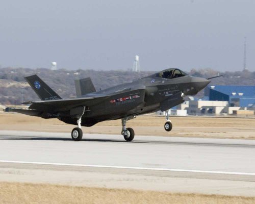

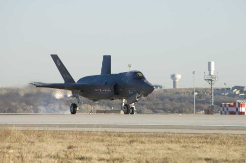

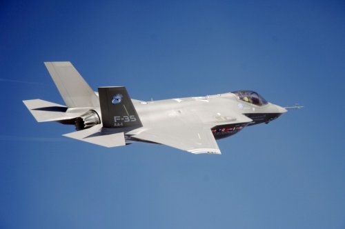

LOCKHEED MARTIN F-35 LIGHTNING II STEALTH FIGHTER COMPLETES FIRST FLIGHT
Fort Worth, Texas, December 15, 2006 --
The Lockheed Martin [NYSE: LMT] F-35 Lightning II lifted into the skies today for the first time, completing a successful inaugural flight and initiating the most comprehensive flight test program in military aviation history.
The first F-35 Lightning II flew for the first time on Friday, Dec. 15. The plane is shown climbing out shortly after takeoff from Lockheed Martin in Fort Worth, Texas. The stealthy, multi-service F-35 is the most powerful single-engine fighter in history, and is designed to replace the F-16, F/A-18 Hornet, the Harrier and the A-10.
F-35 Lightning II lifted into the skies today (JPG, 1.79 MB High-Resolution Photo)
F-35 Lightning II First Flight Photo (JPG, 2.04 MB High-Resolution Photo)
The Lightning II performed beautifully,” said F-35 Chief Pilot Jon Beesley following the flight. “What a great start for the flight-test program, and a testimony to the people who have worked so hard to make this happen.” The most powerful engine ever placed in a fighter aircraft – the Pratt & Whitney F135 turbofan, with 40,000 pounds of thrust – effortlessly pushed the F-35 skyward.

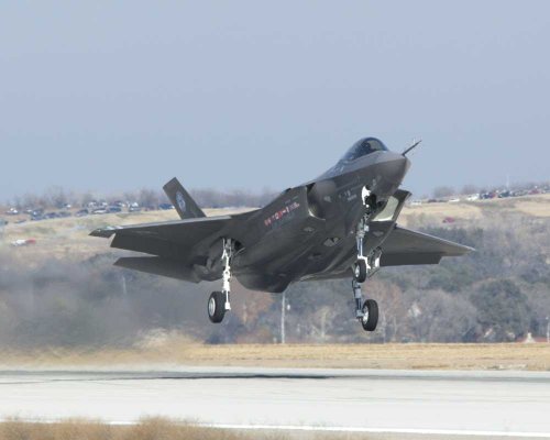

Just got this from a chap at LM - 2nd F-35 flight, this time with wheels up.
Sentinel Chicken said:
What belongs to that air scoop above the right intake?
I believe that's the intake for the ECS heat exchanger but I'm not totally certain. If I'm wrong, I'll get back to you.
