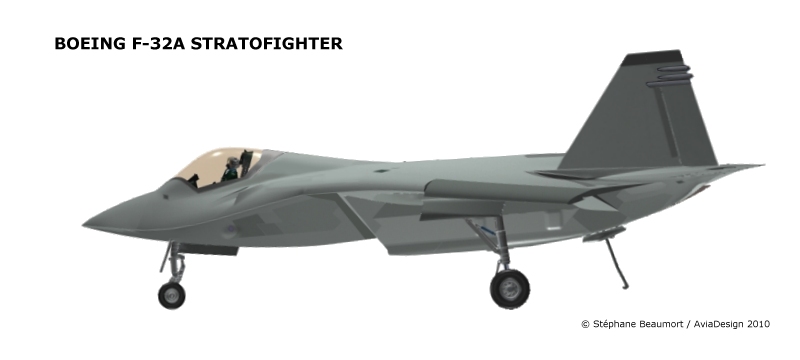

AG - Nonconcur, as the services tell the GAO. It takes five minutes with an unbuttoned F-35 to see the screaming complexity involved in wrapping subsystems and wire/line runs around the outside of the storm drain where the engine goes. And anything forward of the lift-fan bay has to wrap around another 50 inch hole, conveniently orthogonal to the other one.
It's on the record that much of SWAT had to do with underestimation of the weight of systems hardware, brackets &c. Much to be said for a twin, with a well-protected central spine that can carry services.
It's also on the record that the F-35B was the critical issue in SWAT, so all the manufacturing disasters that followed (due to simple designs being abandoned for lighter and more complex structure) can also be attributed to STOVL.
Interestingly, the X-32 mostly avoided this problem in that the underwing nacelle was separate and had less non-propulsive moving hardware in it. Not to say it would have worked better, overall.
A twin-414 USN/USAF jet would have cost less, been easier to design and offered higher performance... sort of a Super Rafale.
Exactly and this is the point I have been making in this recent discussion. There is not some great inherent issue towards designing a joint fighter that can STOVL and not STOVL that makes it overly complex, impossible, bound to fail, etc. Sure there are problems with the F-35 but that is in part because of the configuration selection by Lockheed.

Anyway, just for your enjoyment (and strictly off-topic) here's what an F-32 could have looked like with more consideration for looks...
(existing photo and art reworked by yours truly). If this is inappropriate here, let a mod remove the post, I won't be offended! (I will also post the stuff in my gallery).
