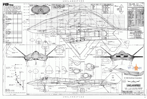

CxxTxx said:
Perhaps you could direct me to the part that says "there is no area ruling". Your words, "does not conform to the Whitcomb area rule". Here's a revelation that is going to shake you to the core - no aircraft does. It's not a matter of either it does or it doesn't. It's a matter of trying to get as close as you can. Some manage it better than others. None get it perfect. Not even the YF-23:

Burbage's quotes on cross-section area stand, and if you did a CS plot on the F-35 like the one on the YF-23 drawing it would be a good deal different.
The F-35A OEW is not far off that of the Super H, which is 66 feet long to the F-35's 51.8 feet (shorter than an F-16). Indeed, if you measure the body from radome tip to the end of the turkey feathers (that is, where almost all the mass and volume resides) the F-35 isn't much (if at all) longer than a Gripen. If you want to know why, look at pictures of the RN variants from the CDA phase.
And it's not just OEW but having a body that has lots of empty space in it, even when armed. And from the CS distribution point of view, I would argue that it is suboptimal to have to make room for a fan that's damn nearly as big as an Embraer 190 engine right behind the cockpit.

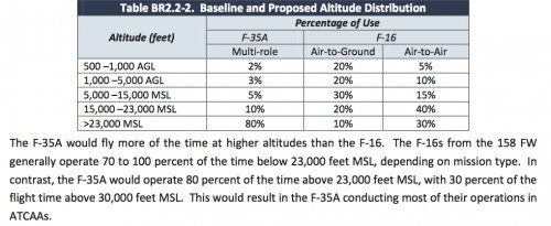

In any event, I'm not sure what you can infer about the F-35A's overall A2A capability based on test centered around combat
altitudes 10,000 ft. lower than the Korean War mean against an opponent which spends most of its A2A time there.
