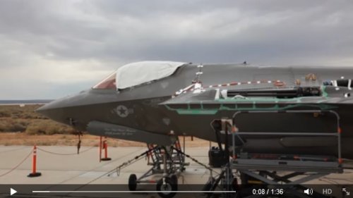

Remember "the gun won't fire until 2019" nonsense?
https://www.facebook.com/bryan.thompson.7505/videos/vb.542946196/10153428199151197/?type=2&theater
I wonder if any of the naysayers will show up to say they were wrong. I'm thinking they'll try to pretend just as hard as they can that the gun didn't fire. ;)
Without actually looking, was that Sarge Mac-and-Cheese over at DoDBuzz? (Edit: I guessed wrong.)
