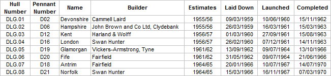

Eight ships were built in both timelines as follows:
However, they weren't the same as the OTL ships.
