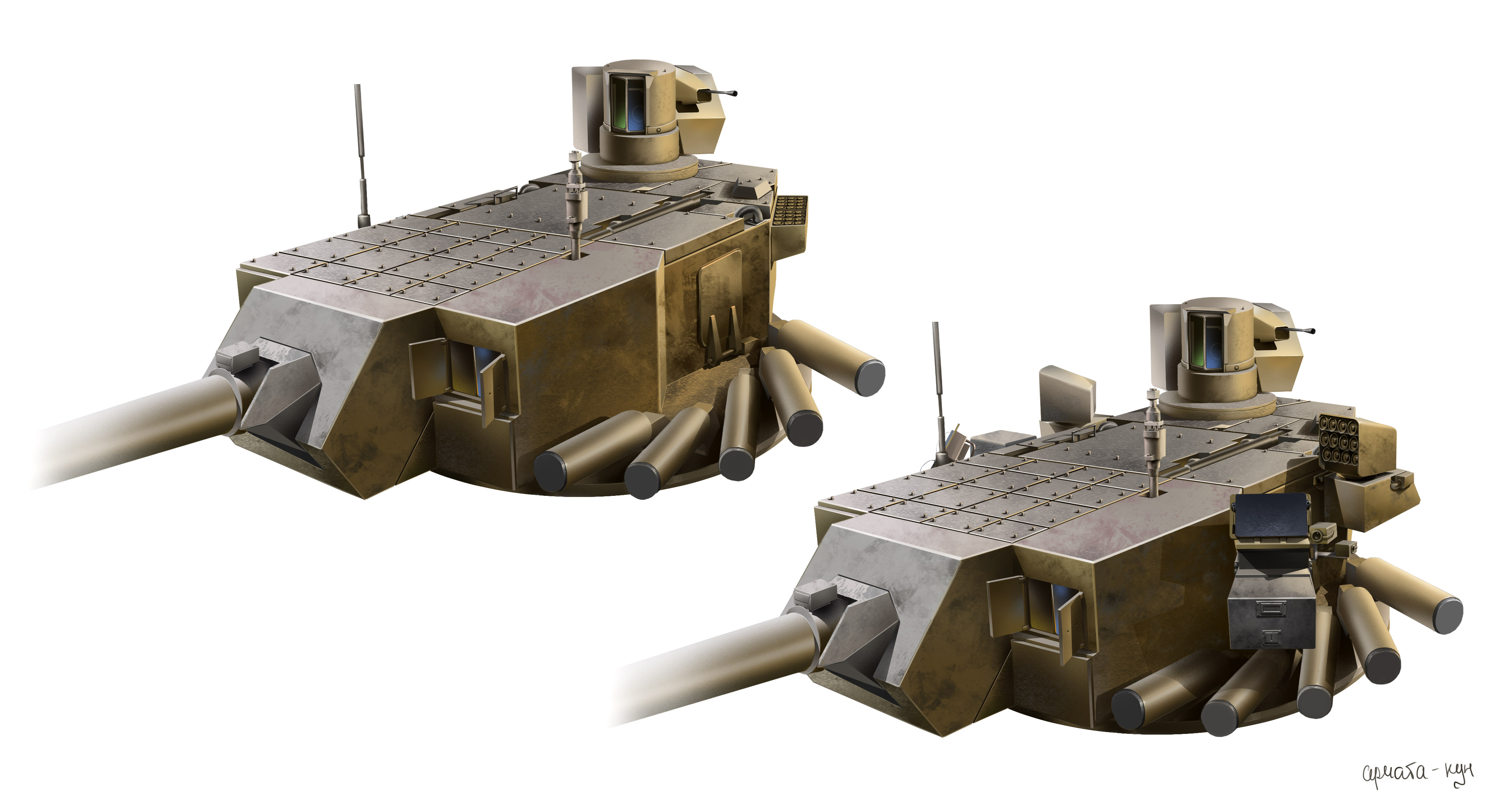

I reworked the T-14 Armata article on wikipedia.
The version before had crude translations from Russian sources, was misleading and used many wrong expressions.
I invite you guys to further refine it.
I wasn't sure which of the two machineguns was coaxially installed with the turret roof sensor, for example.
The missile launch by main gun was previously presented as if it was a novelty; I added that this was introduced by the Soviets already, but didn't remember by which tank exactly and in which year.
BTW, I think at least the rooftop radar is almost certainly a special kit, not to be installed on all tanks. Maybe one per company. Its claimed range of up to 100 km is very questionable, but I lack sources to refute it.
