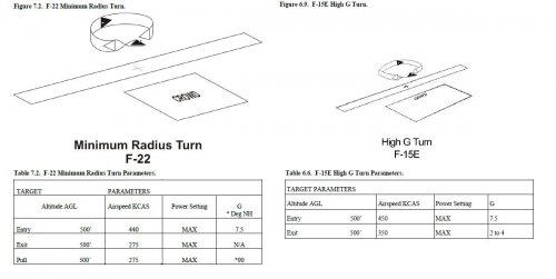

From MAKS 2013 airshow
T-50 is doing 360 turns in 18-19 seconds, already comparable to Su-35S and F-22. T-50 is also not using max power in those turns.
http://www.youtube.com/watch?v=LoFmbLm-oKg
At 3:55, the plane does near vertical climb while accelerating. Acceleration is quick and noticable, I have never seen any aircraft with such power. This is not even using second stage engines.
And remember T-50 is only showing 40% of it's potential here.
source?
ok what are the power settings then? How much does the aircraft weigh? How much fuel is on board?
based on awhat experience? relative terms like "quick" and "noticeable" don't do you any favors either.
Source?
Compare that climb with F-22 during airshows. You will see the T-50's climb acceleration is very quick and noticable. If F-22 isn't hold back at airshows, T-50's climb and acceleration performance will exceed it even with weaker 117 engines.
40% is from Sergey Bogdan interview during MAKS.

Compare the T-50's climb in the video with F-22 climb in airshows. Here is description of F-22 airshow maneuvers. The climbs are done at max power. http://static.e-publishing.af.mil/production/1/af_a3_5/publication/afi11-246v1/afi11-246v1.pdf I have yet to see F-22 do a compareble climb.

Yes its holding back at airshows. There are flight restrictions at western airshows.
There is a whole world outside of youtube--Just because you have not seen it on youtube doesn't mean it does not exist.
According to Metz the F-22 pilot:
The fastest way to get to altitude in a Raptor is to accelerate to supersonic on the deck and climb all the way supersonically.
Not surprisingly, you won't see that at an airshow. I've also never seen an F-22 at 60,000ft in an airshow video before either, so its probably not capable of such heights.
