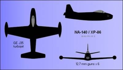

Nope. The FJ-1 was NA-134, the XP-86 was NA-140. The straight-wing XP-86 apparently was NA-136 [it wasn't*]. Actually this was discussed recently in another thread. Are you sure there was a mock-up, anyway? Here's an illustration, which I suspect is a later composition, not an original NAA illustration:

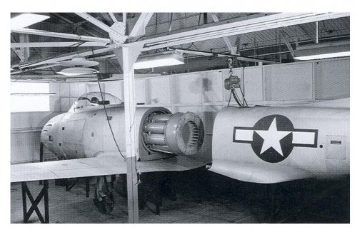

From "Wings of Fame" Volume 10 Page 38:
"The straight-wing project proceeded as far as a wooden mock-up of the left wing and fuselage, complete with dummy J-35 engine. It was unveiled at Inglewood in June 1945"
From Squadron Signal's second F-86 in action (#1126):

I think that you will find, under closer analysis, that the Squadron/Signal "XP-86" drawing is much closer to representing a FJ Fury than an XP-86.
This is also what I thought, but until we get a proper NA-136 straight-wing XP-86 profile, I guess that's the closest we're going to get...

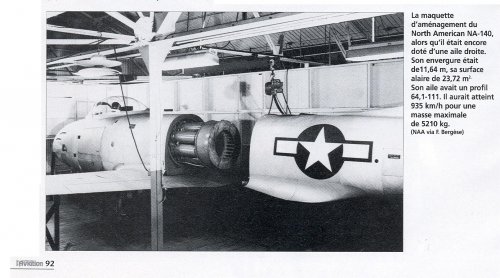

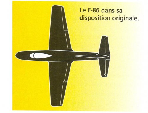

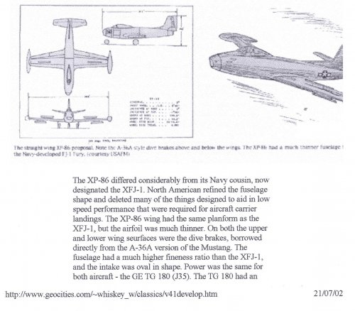

I have found some additional info from
-"La flèche fait la différence"-Le fanatique de l'Aviation unknown issue
-"U.S. Experimental & Prototype Aircraft Projects-Fighters 1939-1945- by Bill Norton .Speciality Press 2008

The XFJ-1 had the same wing-mounted dive brakes as the XP-86. This was changed for production to the fuselage-mounted brakes, reportedly due to a roll-control incident on a test flight following a jam of the wing-mounted brakes on one side. The FJ-1 engine was also removed through the top of the fuselage rather than removing the aft fuselage, apparently to minimize the deck space required for an engine change.

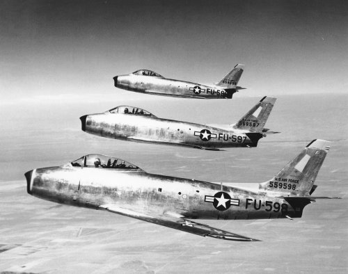

I for am glad they abandoned the straight wing concept. Otherwise we would have never gotten these beauties.

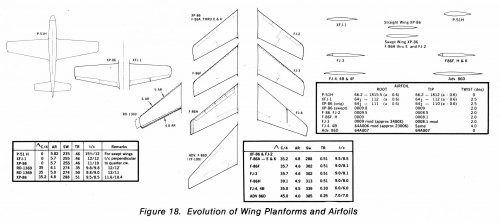

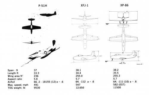

Scans from:
Evolution of the F-86, By Morgan (Mac) Blair
AIAA Evolution of Aircraft Wing Design Symposium, March 18, 1980.
Figure 5 shows the P-51H, XFJ-1, and original XP-86.

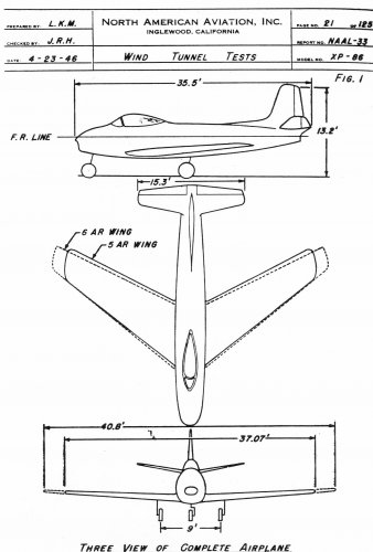

Figure 11 shows the initial wind tunnel configuration with alternate wings with aspect ratios of 5 and 6; and unswept tail.
Figure 13 shows further refinement; fuselage cross section has been revised.
Figure 18 shows the relationships between the wings of the North American fighters.

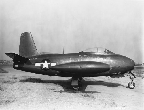

I recently acquired a number of NAA Columbus FJ Fury photos and amongst them was this photo of the XFJ-1. I'm posting it for the sake of completeness/comparison on the topic since the production FJ-1 differed in detail.
Enjoy the Day! Mark

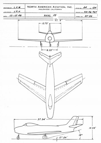

Does anyone have, or know where to find, dimensions and drawings of the North American NA.140, the later F-86 Sabre, only with straight wings? Thanks in advance!

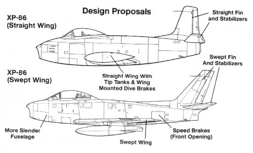

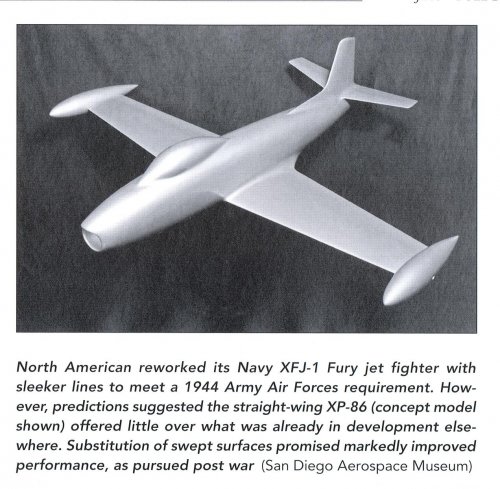

The recent Hatchette bookazine on the F-86 has a lovely-sized three-view of the straight-winged proposal along with mock-up pictures and a picture of a desk model. It also has a three-view of an intermediate swept wing study that retains the straight tail surfaces.

aim9xray's Figure 11 above is the intermediate step drawing I mentioned.

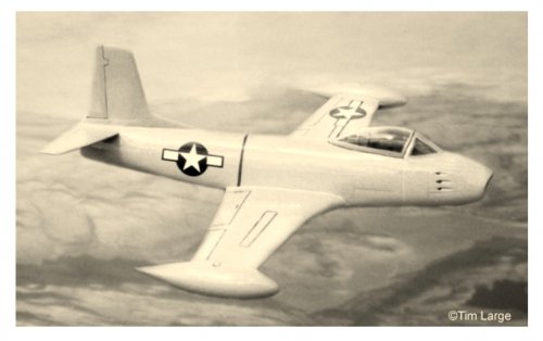

Would anyone be interested in a 1/72 kit of the straight wing NA.140 version?
I, for one, would. Been looking at crossing bits from a F-86A and a FJ-1 as the starting point for modeling one; a kit would be simpler.

A single photo of the straight wing XP-86 appears on page 6 of "WARBIRDTECH Series: North American F-86 SabreJet DAY FIGHTERS, Volume 3. The caption reads: The only known photo of the XP-86 straight wing design at mock-up, which was unveiled at Inglewood in June 1945. Only the left side of the mock-up was finished and inspected on June 20, 1945. Although the XP-86 never went beyond the mock-up stage, its Navy cousin, the XFJ-1 Fury went into full production, becoming the first operational jet fighter for the Navy. (NAA)"
