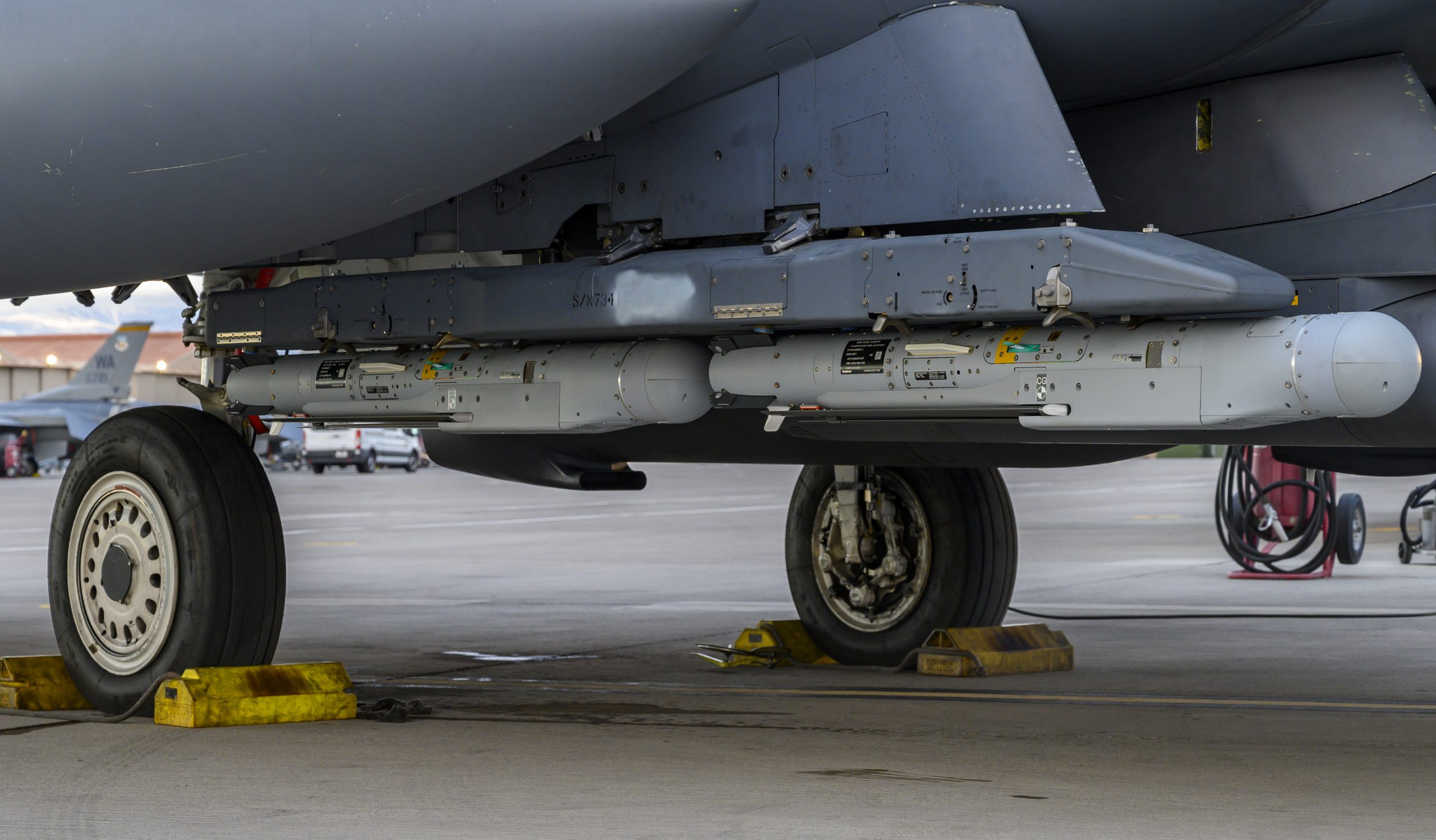

The Joint Direct Attack Munition is a guidance tail kit that converts existing unguided free-fall bombs into accurate, adverse weather "smart" munitions.
www.af.mil
Once released from the aircraft, the JDAM autonomously navigates to the designated target coordinates. Target coordinates can be loaded into the aircraft before takeoff, manually altered by the aircrew before weapon release, or automatically entered through target designation with onboard aircraft sensors. In its most accurate mode, the JDAM system will provide a weapon circular error probable of 5 meters or less during free flight when GPS data is available. If GPS data is denied, the JDAM will achieve a 30-meter CEP or less for free flight times up to 100 seconds with a GPS quality handoff from the aircraft.
Russian GPS jamming will only be effective in the last few km of flight. It will get decent GPS data at launch and will continue to receive data on the way to the target.
Basically its unlikely the CEP will veer that much off target, they might get a CEP of 15 metres...which for a 500/1000lb bomb is close enough....Russian GPS jammers are also exceptionally rare and high value. They're not going to be within 20km of the front (if that, their effect will drop away as distance and terrain gets in the way), and given what we know about Ukrainian use of JDAM/JDAM-ER and the way their aircraft will have to release it (i.e low and fast from a pop-up loft profile) they're not going to be targeting much beyond 10-15 km of the front line....
