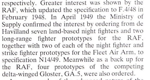

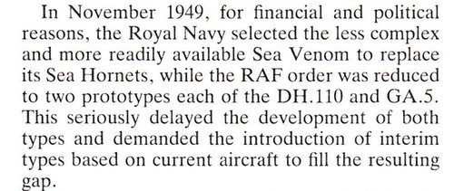

Here's something! It was presumably a non-night fighter version of the DH-110.
From Ian Birtles, Postwar Military Aircraft 5 - de Havilland Sea Vampire / Venom / Vixen (Ian Allan)
