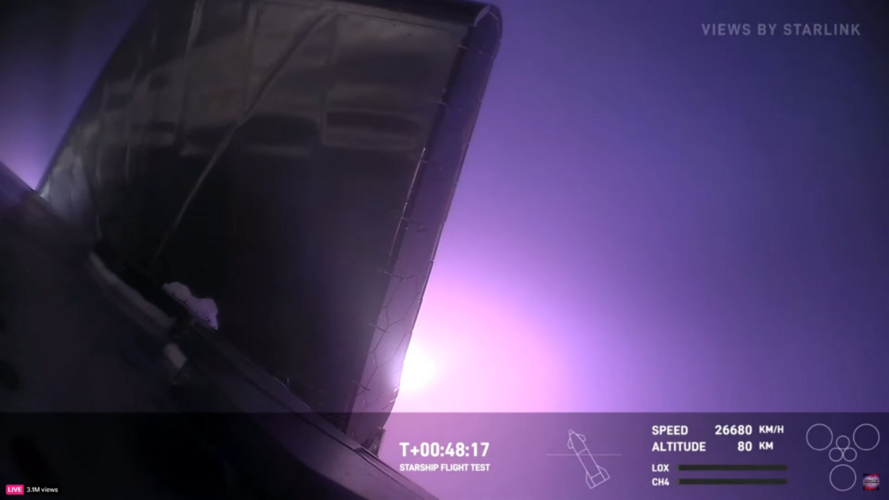

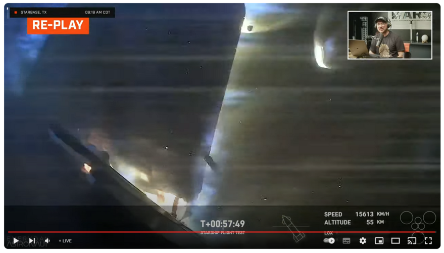

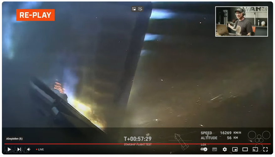

I suspect they do a few suborbital tests first. This was huge progress but it looks like the heat shield needs some work. Booster lost an engine on the way up and another on relight, and while it can survive that they will want to address those problems.
I cannot believe that flap could still actuate. It looked like the back quarter or third of it burned through. I would not think it could accurately flip the vehicle after that damage.
More than that, it lost a hinge. At 1:05:45, when the vehicle rights itself and unloads the flap from the wind, you can see the flap tilt in a direction it's not supposed to move in. The entire hinge burned through, and the flap was only supported by the other hinge and the actuator.

I was absolutely awed by this wing. The thermal protection layer failed, slabs were stripped away. Plasma burned right through steel. BUT IT DID NOT FAIL. And it worked when it was required to turn the ship. What an awesome design!
And most importantly it looked gorgeous while doing all of that! Truly remarkable indeed...

It would be hard to get any firm conclusions from the video we have here. Since Starship managed to keep attitude correctly, with precision, and was still conclusively maneuverable for the pitch-up prior to the splash down, we can only infer that the heatshield apparent failure is very localized.
Hence no general conclusion can be rigorously made on the heat dissipation strategy like I read somewhere.
On the other hand, we saw a lot of micro debris below 50km alt while the speed was still incredibly high*. We could then suspect that a localized degradation propagated toward the canard joint but that the overall system performed appropriately.
Did these debris came from Starship or were there environmental? Hard to say at this stage.
*I am on the opinion that Starship came down too fast and should have pitched-up to cool down the structure before re-initiating the descent.
