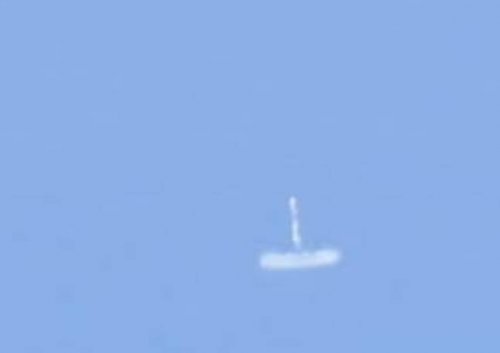

Falcon 9 1st stage hovers over the Atlantic ocean after boosting the Dragon capsule to the ISS on Sunday. Vehicle is hovering around 9 meters above the water. There is a video at the Spacex Youtube website showing the Falcon 9R (re-useable) undergoing first powered hover flight. Boeing and Lockheed are probably quoting Inigo Montoya about now: "I wonder if he's using the same wind we are using?"

As sferrin pointed out, that's not even close to an accurate description of that photo (wrong flight, wrong side of the continent, and very wrong altitude... it's not hovering above water, but Way Up There restarting an engine). And so, inquiring minds want to know: where did *your* description come from? Seems odd that it would be so wrong and yet so specific.

My bad. I did an image search for a water landing of the Falcon 9 and this picture showed up. I had never seen it before and assumed it was for Sunday. The caption mentioned the specifics on hovering.
Spacex doesn’t release its’ photos right away (and they don’t have to since this is privately funded). This is what comes of not wanting to wait for the official release. Elon Musk had tweeted that the booster had indeed made a successful re-entry and this picture dovetailed with that. Lesson learned. Official release or multiple sources.
