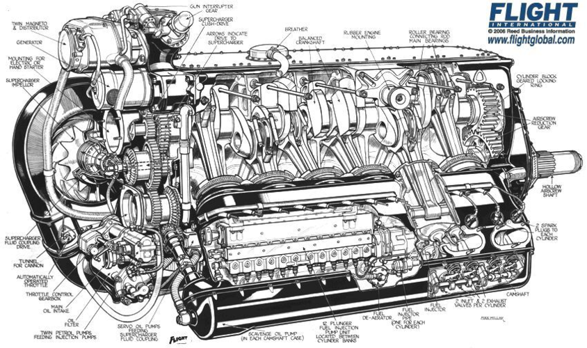

A DISCUSSION ABOUT ALLIED vs. AXIS Super-Charger Drives: Recently I had several exchanges with an author of a recently published, well-researched book on WW2 aero-engine development. I was rather interested in his commentary on the merits of the use of the Föttinger hydraulic coupling employed by Daimler-Benz in the DB-600 series engines. It's rather obvious that an infinitely variable drive will offer smooth transitions in boost level to track changes in altitude in contrast to the seemingly archaic 'staircase' boost intervals produced by fixed-ratio, multi-speed gear drives. However, there is always a penalty to pay, namely poor transmission efficiency, leading to poor fuel economy on top of an already thirsty engine. He rather astounded me by stating that the hydraulic coupling saved 10% of engine power on take-off (altitude performance not stated). I remain somewhat sceptical. My understanding from what I've read of hydraulic couplings of the Föttinger type is that transmission efficiency barely rises above ~80% (see: https://journals.sagepub.com/doi/abs/10.1243/PIME_PROC_1948_158_015_02?journalCode=pmea) whereas a well designed meshed gear-train can and often does exceed ~90%. That's by no means the only issue, the early DB's were prone to over-heating of the hydraulic fluid although apparently solved in later marks. Usually this requires additional cooling capacity which in turn means more weight and incurring a parasitic drag penalty to boot. Moreover, the Föttinger super-charger drive still requires a step-up gear and it's efficiency losses are additional.
My understanding is that the R.A.E. extensively tested salvaged DB601's and I believe that ROLLS-ROYCE separately tested the DB601, not forgetting that, vice-versa the Germans also comparatively tested salvaged Allied aero-engines [Does anyone have copies of any of these reports?] I am given to understand that the British acknowledged the benefits of this form of super-charger drive yet ROLL's persevered with the change-speed gear drive. I assume that they did so due to the greater mechanical efficiency of this drive albeit prepared to suffer the additional mechanical complexity and the occasional 'crack-ups' (!).
But am I wrong, was the Föttinger in fact, actually more efficient? Intelligent analyses, please.
As if to further complicate the issue, it should not be over-looked that a variant of the American ALLISON V-12 also employed a hydraulically coupled super-charger drive but oddly, this was never extended to other variants in the range. Why was that? Did they encounter problems that were just too difficult or time-consuming to solve or were there other more prosaic reasons?

A DISCUSSION ABOUT ALLIED vs. AXIS Super-Charger Drives: ......................... He rather astounded me by stating that the hydraulic coupling saved 10% of engine power on take-off (altitude performance not stated). I remain somewhat sceptical. My understanding from what I've read of hydraulic couplings of the Föttinger type is that transmission efficiency barely rises above ~80% (see: https://journals.sagepub.com/doi/abs/10.1243/PIME_PROC_1948_158_015_02?journalCode=pmea) whereas a well designed meshed gear-train can and often does exceed ~90%. ....................................
My understanding:
At take-off the DB engine supercharger would run at lower speed (thanks to its hydraulic coupling) than the Merlin supercharger, and therefor use less power from the crankshaft than the Merlin. That outweighed the difference in transmission efficiency.
The only way for the Merlin to avoid too high boost pressure (avoid knocking) during take-off was to throttle the supercharger inlet.

The German DB601 engine superchargers were geared between engine and hydraulic coupling, so as to increase the SC speed far above that of the engine, just like in the Merlin.
The hydraulic coupling transferred this high speed to the SC, with the possibility to reduce the high speed somewhat so as to limit the boost at take-off and altitudes below critical altitude.

In a DB engine the supercharger and hydraulic drive both run at about 10 (ten) times the speed of the crankshaft.
What matters with both is the tip speed. Running them at a lower shaft speed would require a larger diameter to achieve the same tip speed.
If the hydraulic coupling would have run at the speed of the crankshaft (with the gears for the supercharger aft) its diameter would have to be too big to fit in a streamlined engine.
Moreover the supercharger in a DB engine is on the side of the engine, not at the back like with a Merlin. Presumably that was done to have room at the back for the cannon that fired through the propeller shaft. In such configuration gears between hydraulic coupling and supercharger would be impractical.

Pratt & Whitney adopted hydraulic variable-speed supercharging around war's end. The Goodyear F2G Corsair used the single-stage variable speed R-4360-4 and the later Grumman F8F-2 Bearcat used the R-2800-30W, also single-stage. The Vought F4U-5 used the two-stage R-2800-32W with dual "sidewinder' hydraulic first stages and a mechanical second stage.
Same with the Packard V-1650-19. I've seen a chart (can't find it now unfortunately ) showing how well the variable-speed supercharger filled in the "saw teeth" of the two-stage V-1650 Merlin's output.
Junkers came round too. IRRC both the Jumo 213J and 222E/F employed two-stage superchargers with hydraulic first- and mechanical second-stage drive. In 1943 BMW successfully tested a 2000 PS 801E with single-stage hydraulic variable-speed supercharger but for some reason it was not adopted.
The Japanese (Aichi for the Navy and Kawasaki for the Army) copied DB techology. The USSR never tried it during the war.
AFAIK the variable-speed supercharger was never contemplated for adoption in Britain.
The "efficiency" of supercharger drives needs to be judged taking account of the mode of fuel insertion, whether by direct injection (which supports full cylinder scavenging and internal cooling through wide valve overlap) or by carburetion (which doesn't). Direct injection favours lower sfc.

when regarding the efficiency, you should keep in mind, that throtteling is required in a fixed stage, mechanical drive train for the superchargers. It s better to have the enegry losses in the coupling, where the heat can be transfered to the cooling system, than by additional gas work (by throtteling and supercharging) which increases the charge temperature.

You also forget that it's not just about ROLLS-ROYCE; what about Allison and Junkers who had already invested R & D and yet did not extend hydraulic coupling driven super-chargers across their engine range. Why??
Late to the party ....
Never the less. Supercharger(s) that have impellers driven via hydraulic coupling have considerable advantage over the impellers(s) driven via 1-speed gearing at lower altitudes. Advantage is less pronounced vs. impellers driven via 2-speed gearing, since the additional low-speed gearing will mean that less of engine power is 'sacrificed' to drive the supercharger's impeller. Junkers have had a 2-speed supercharged Jumo 211A by the time DB made the 601A (and the 2-speed S/Ced Jumo 210 versions even earlier), while RR had the Merlin X and were preparing the Merlin XX for production.
Allison have had the hydraulic-driven impeller of the auxiliary S/C stage in production by 1943 for the P-63.
We can note that DB 601/603/605 also employed throttling, especially under 2 km of altitude. Thus the take off power in practice was still not better than on comparable Jumo engines, or vs. the 2-speed supercharged RR engines.
Also, and probably more important: improvement in supercharger system beats the presence of hydraulic coupling for the S/C. Here the German engines started lacking vs. RR engines as war dragged on.

I think that we're mostly in agreement. Plus, British and Germans were installing the engines with two-speed superchargers in their bombers by the time DB 601A materialized, it's supercharger drive offering, in theory, an infinite number of speeds between the min and max ratios. Advent and wide use of 100 octane fuel by the RAF meant that Merlin III, XII and 45 (engines usually used on fighters) were still useful engines at lower altitudes, too, despite having just 1 speed for their respective superchargers. Hi-oct fuel allowing for greater boost pressures (and thus power) without the detonation despite the throttle being open under the rated height.
As for the V-1710 with hydraulic coupling, that was used to drive the impeller on auxiliary S/C of engines used on P-A/C/D and P-82E. The engine-stage S/C still used 1-speed drive. Auxiliary S/C + engine-stage S/C = 2-stage supercharging. A few thousand of those engines were produced.
