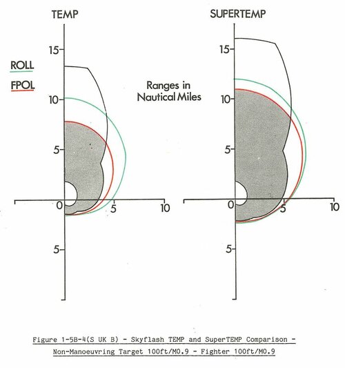

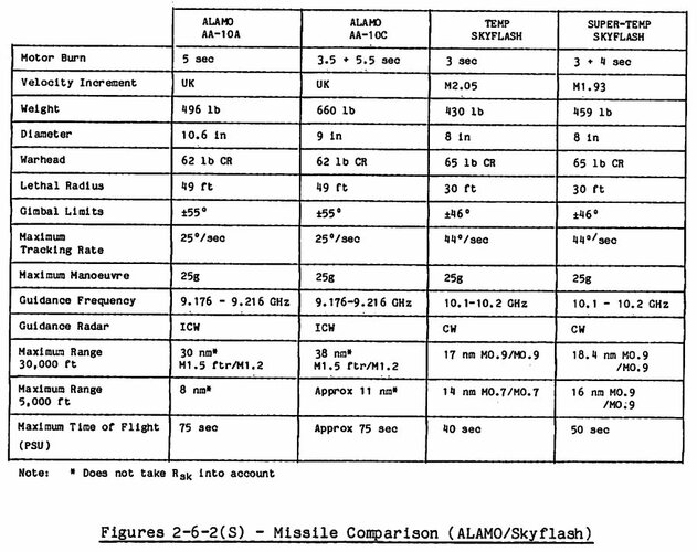

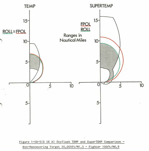

Through a friend on the War Thunder forums I've managed to obtain a copy of the now declassified Central Tactics and Trials Organisation (CTTO) Tactics Manual for the Tornado F.3. It's the first time I've ever seen any primary source information on the SuperTEMP.
I've attached a table containing the characteristics of the Skyflash SuperTEMP, as well as a couple of the firing envelopes. Key takeaways:
  • The Hoopoe motor has a 3 second boost stage and a 4 second sustain stage
  • As a rule of thumb the maximum range of the Skyflash SuperTEMP is 75% of the AIM-7F's range under identical conditions.
