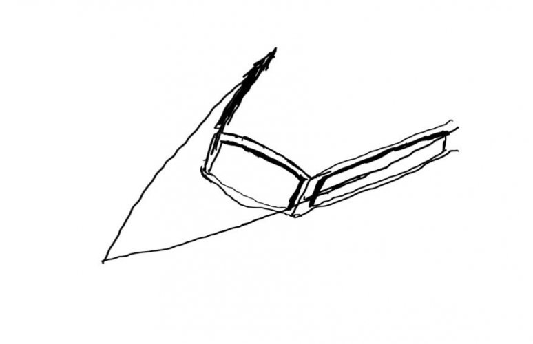

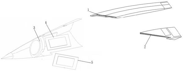

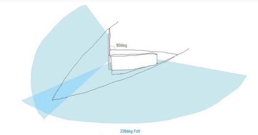

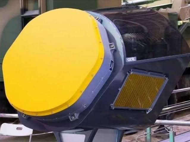

Doesn’t the beam attenuate towards the edges of the radar? I’d imagine there will be some tradeoff form looking at head on targets.
I dont really see that as a concern. If you think of the total system then instead of each ship staring forward, each ship simply covers adjacent ships' sectors (total fused picture makes this a lot less confusing than in the past). When you bring in other offboard sensors into the picture like CCAs, AWACS, and legacy platforms, this becomes even less of an issue. Instead, it seems advantageous to me that the ownship arrays would be tailored for immediate tactical needs, and sidelooking arrays seem smart in that regard.
I'm not sure, not enough of a radar nerd to understand that.
It's my understanding that the overlap between the two arrays at ~45-50deg ~90-100deg eliminates that issue.
Edit: used sweep angle, not full included angle between arrays.
