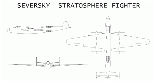

In fact, I cannot help the feeling, that the artist had put a little bit too much “art” in his drawing.
Besides the openings in the middle fuselage, I cannot see anything, that would guarantee sufficient
cooling for the two engines, which would have to be of a very powerful type indeed, just in order to
lift this conglomeration of guns. Landing gear probably would have been of tricycle type, as a classical
tailwheel landing gear would have needed quite long main gear legs, to give sufficient ground clearance
for the aft props. A nother detail, that puzzled me, was the cockpit, which seems to be offset to the
left hand side of the fuselage. But as the dorsal fuselage itself gave no other indication of this, I put it
on the centerline. So, to my opinion, if Seversky really was planning to built a multi-engined high-
altitude fighter, it quite probably would have looked very different.
But, to be fair, maybe the artist back in 1938 was just tasked with making a drawing of “a twin engined
fighter with fuselage mounted engines, but, please, make it well armed !”
