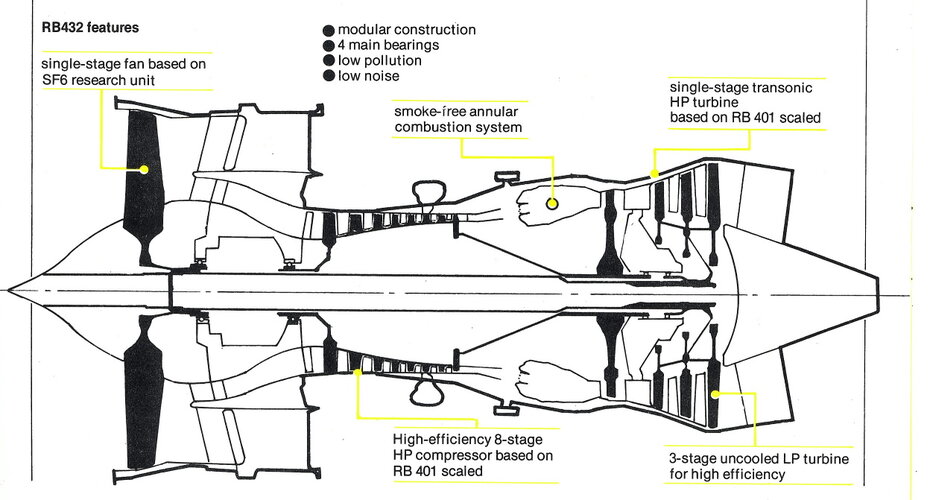

The RB.432 is an unbuilt design for a turbofan in the 18,000 lbf/80 kN thrust class, for airliners of up to 150 passengers. This project ran in the late 1970s. The Fokker Super F28 brochure devotes one page to the engine.
It's a two-shaft turbofan with a bypass ratio of 4.8.
Ultimately the engine was not proceeded with, but the design was used to inform the RJ500 (joint project with JAEC, cancelled) and the V2500.
