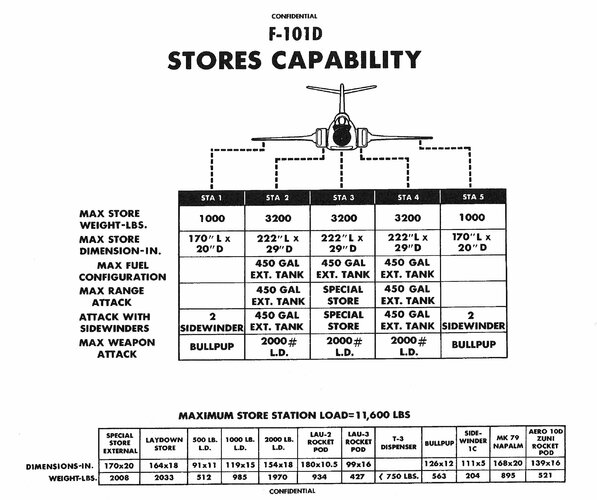

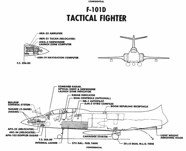

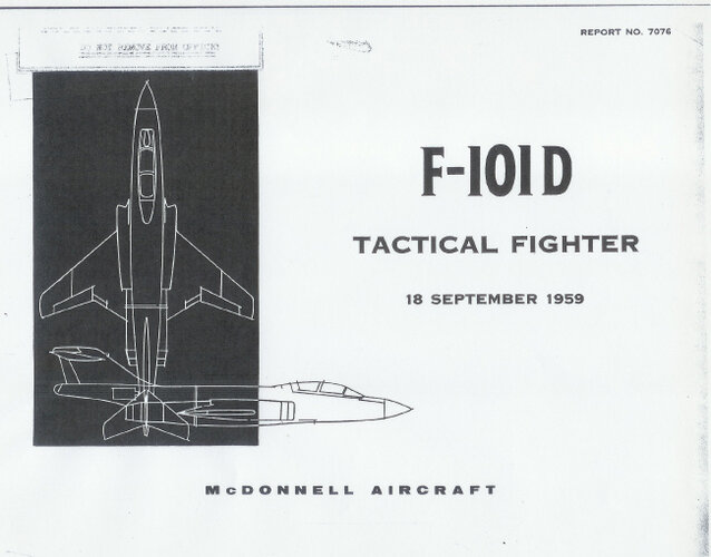

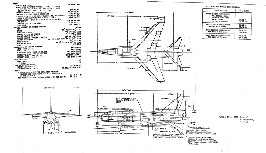

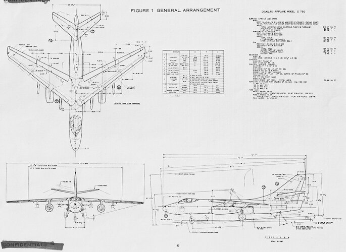

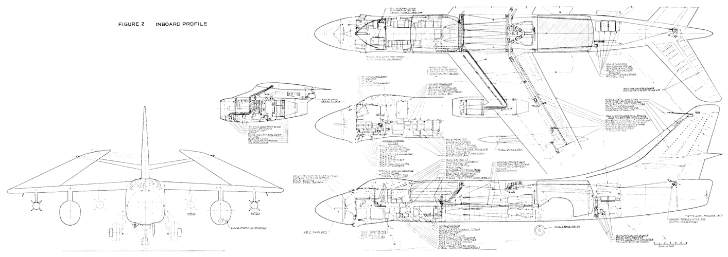

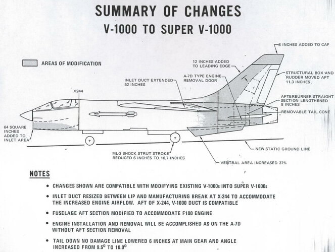

Douglas, McDonnell, and Vought would later submit proposals based on their existing military aircraft designs which swapped out the Pratt & Whitney J57 for the General Electric J79:
  • Douglas D-790 (Air-to-air variant armed with AAM-N-10 Eagles for fleet air defense)
  • McDonnell F-101D/E (Proposed tactical fighter variants with variable ramp inlets)
  • Vought V-1000 (Land-based export fighter offered to replace the F-5 Freedom Fighter)
Although none of these proposals ever made it past the blueprint stage, the designs seem to imply the technical feasibility of replacing the J57 with the J79.
Could other J57-powered military aircraft designs such as the F-100 Super Sabre and F-102 Delta Dagger be outfitted with the J79?
Hypothetically, could these J57- / J79-powered military aircraft designs also be upgraded with modern low-bypass turbofan engines such as the Pratt & Whitney PW1120 or General Electric F404?

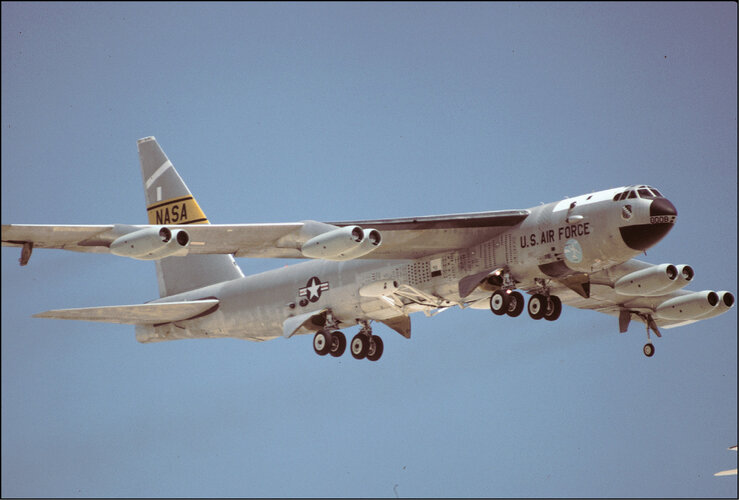

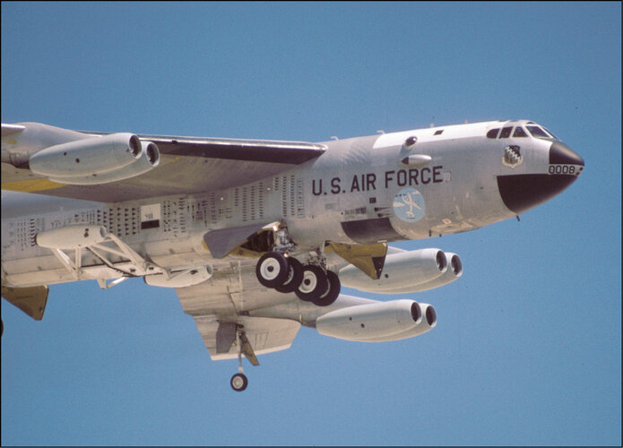

And NASA's "Balls-Eight" (52-0008) flew with ten engines...
Not exactly... (the devil is in the outliers!)
A B-52A had all four outboard J57s (Engines 1,2 7 & 8) replaced by two J75s as a testbed.
A B-52G had all J57s replaced by TF33s as a testbed. The aircraft was later demodified and went to SAC as a standard, combat-ready B-52G.
I'm not willing to count testbeds as engine swaps. They're one-offs.
What were the extra two engines, and where were they attached?
