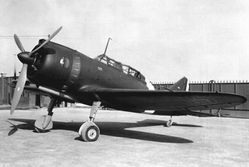

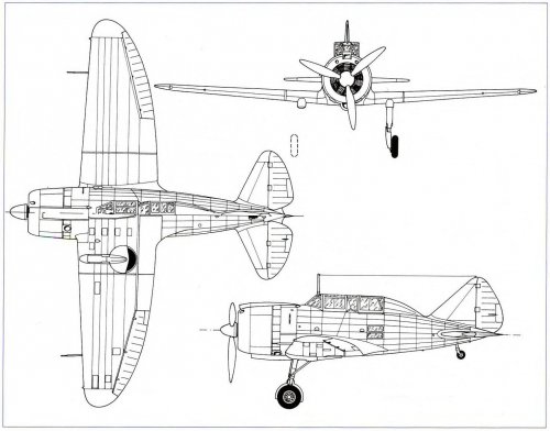

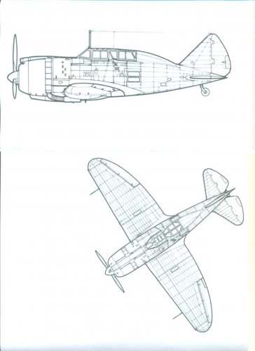

cluttonfred said:Interesting that it is a two-seater but with no obvious provision for defensive armament. In the recconnaisance role that might make sense if you are going in fast and high, but in the light bomber role?

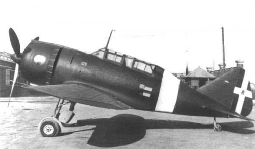

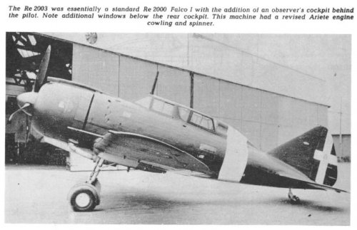

Apophenia said:There was also glazing added to the rear cockpit floor to facilitate observation. Did the 'osservatore' also directly operate the camera, I wonder?
Apophenia said:Apparently, the shape of the glazing of the rear canopy was at the request of the Ministero dell'Aeronautica. There was also glazing added to the rear cockpit floor to facilitate observation. Did the 'osservatore' also directly operate the camera, I wonder?
It is odd that the Direzione del Genio e delle Costruzioni Aeronautiche thought that ricognizione aerea could be performed by an aircraft without rear defence armament. Perhaps it was because the Re.2003 was so much faster than the Ro.37bis it was to replace? But, as cluttonfred noted, that still would not explain why no rear defence for the ground attack role also required of the Ro.37bis and its potential replacement.

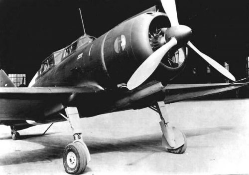

Maybe a night fighter variant?Jemiba said:Apophenia said:There was also glazing added to the rear cockpit floor to facilitate observation. Did the 'osservatore' also directly operate the camera, I wonder?
Probably, just as a bomb aimer releases the bombs. But forward view would hardly be helpful then. To me, it looks like a
mission transferred to a trainer version as an afterthought. Windows in the underside probably can be added quite easily.
Have looked for a trainer version of the Re.2000, but without success.
Jemiba said:... To me, it looks like a mission transferred to a trainer version as an afterthought. Windows in the underside probably can be added quite easily. Have looked for a trainer version of the Re.2000, but without success.

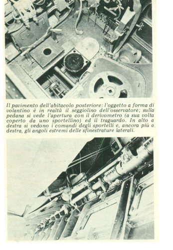

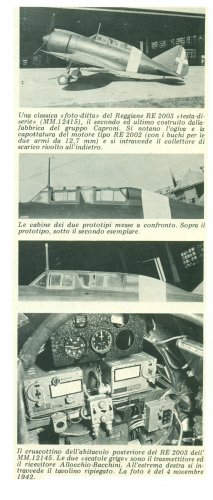

In esecuzione ad ulteriori istruzioni emanate dal Ministero, la cabina dell'osservatore venne successivamente modificata per migliorarne la visibilità e vi venne predisposta l'installazione di una macchina fotoqrafica panoramica e di una macchina foto planimetrica.
http://www.alireggiane.com/t338-re-2003
Apophenia said:Jens: I agree that the rear glazing looks like that of a trainer but those windows were shaped that way as the result of requested changes by the Ministero dell'Aeronautica. If the Re.2003 had started out as a twin-seat trainer, surely the Ministero request would have resulted a more streamlined arrangement. It seems that they saw some value in the observer having a degree of forward visibility.
