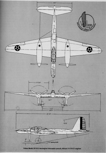

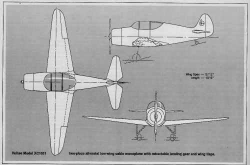

The AAHS article (Vol. 23, No. 1, p. 18-22) is a reminiscence by aircraft engineer Dusty Carter, who began his career in 1936 as an apprentice at Vultee. The article ("Vultee 'P-38'") has two drawings that may be of interest, but nothing about Vultee project nomenclature. In passing, however, it does mention that Curtiss also submitted a design for the competition leading to the USAAC's P-38 program.
Wow. Thank you so much, Clioman, for solving the mystery! I'd never seen these designs before. ;)

I believe the XC.1031 was the Vultee Model 41, because this was the only "2-place cabin project" by Vultee. (Source: Vultee Aircraft 1932-1947 by Jonathan Thompson).

Vultee XC1031 : Two-place side by side light aircaft.
Engine choise : 90 hp. Lambert.
source : AAHS journal Spring 1988, page 22.
Many thanks to you my dear Lark.
Likely a Lambert M-5(?)
They only produced that engine type alongside the R-270.
No mention of a engine type number in the AAHS text..
