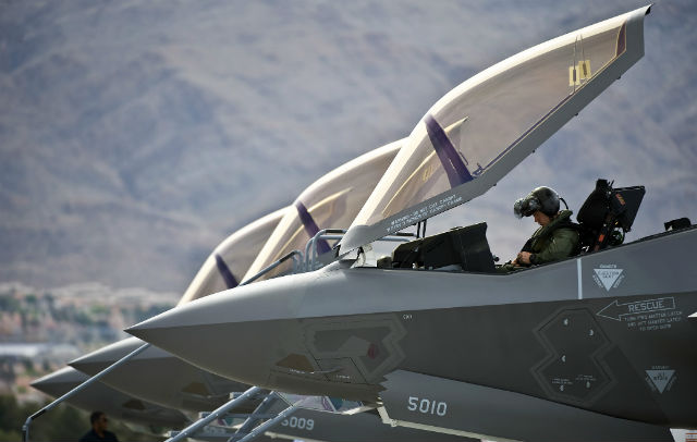

F-35 opens from the front

F-35: commonality.
The aft end of the F-35B canopy is different from the F-35A/C due to the lift fan. Placement of the hinge at the front allows a common drive mechanism (and hopefully reduced cost) across all three variants.
