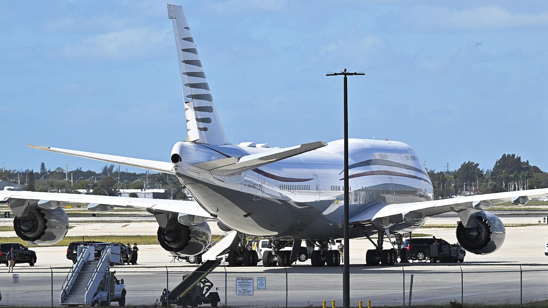

Less political post, all of us so far have ignored the huge security concerns of accepting a foreign operated jet. Qatar has close ties with Iran and its proxy groups. The security consequences of even hosting a president there without completely disassembling the aircraft are profound.
This is what I was thinking too, when that aircraft arrives it will have to be given an extremely detailed, lengthy and expensive inspection of its' airframe and systems for anything untoward (Such as electronic bugs for example).

This is what I was thinking too, when that aircraft arrives it will have to be given an extremely detailed, lengthy and expensive inspection of its' airframe and systems for anything untoward (Such as electronic for example).
That's the basis of a D-Check; all panelling and flooring removed, airframe scanned with x-ray machine for cracks or defirmations, every single engine blade removed and inspected, toilets disassembled and tested. Then put together again.

Then fit a new custom interior, a totally bespoke secure comms system, defensive countermeasures, and all the other special provisions needed for a President to actually do the business of the United States from the plane.
That's a lot more than a D check.

I'd imagine it would take at least a year for the aircraft, if accepted, to hasten the in-service date of the VC-25B, but perhaps not as the actual interim airframe.
The Qatari aircraft's current lack of EMP protection may be an insurmountable issue in and of itself as an AF1 airframe. (Which triggers the question, are the C-32s/757s the President flies in on occasion fully EMP protected? I have no idea. If not, that may point to how the Qatari aircraft may be relatively quickly modified for the President's [possibly only US domestic] use.)
However, the additional airframe may enable one of the two VC-25Bs currently in queue to enter service earlier on an interim, less-capable standard, as the #2 formerly Transaero-slated airframe and then maybe this former Qatari aircraft are modified and completed to the full standard.
At best, it might provide part of a three-plane AF1 fleet, all ultimately modified to a somewhat common standard. The Qatari airframe would be the third and last such airframe modified should be - again, should be - the most straightforward to modify, given lessons learned and the manufacturing process learned and set for first two.
At worst, it will serve as a valuable source of very low-time 747-8 parts and structures for the two VC-25B's and four E-4C's in the years to come, especially given the relatively small 747-8 production run.

Nevermind the full VC-25B electronics fit, which involves adding an amount of wire equal to the existing amount in the plane.
