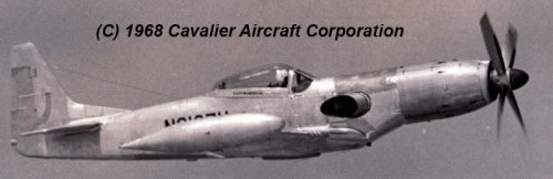

PA-48 can be thought of as son of Turbo Mustang III and grandson of Turbo Mustang II, both developed by Cavalier Aircraft, which at the time was quite successful modifying P-51s into two seaters for privat and executive use. (the Cavalier 2000).

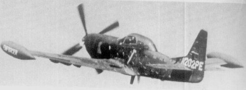

Stargazer2006 said:frank said:So the version that's commonly known as Turbo Mustang III is actually a Turbo Mustang II & the Turbo Mustang III was never built?
No. The Turbo Mustang III that was we know, which was a single prototype, was initially designated Turbo Mustang II and was rebuilt as the very first Piper Enforcer. It was rechristened as "III" in anticipation for a possible production version (following the Mustang I and Mustang II) that never materialized.

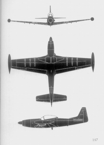

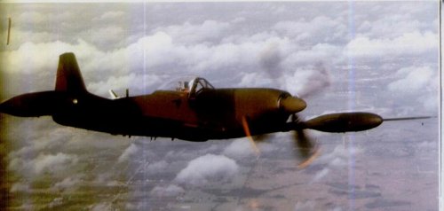

Jemiba said:Two photos from the magazine FLUGZEUG 05/91, showing the Piper PA-48 Enforcer
and another one and a 3-view from "Flugzeuge der Welt 1972" , the German version of
Greens "Aircraft of the World", showing the PE-1 :
