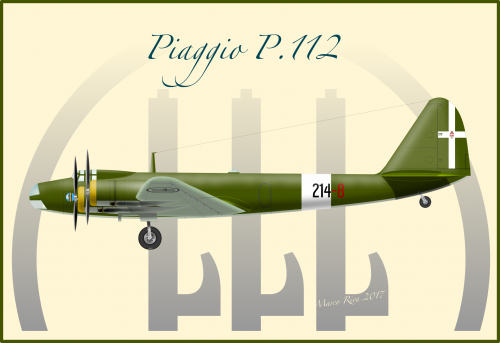

I've published the 114 in the "Artwork" section before stumbling upon this post. So I added also the "sister ship" P.112 to match the original image on Aerofan.
Cheers!
