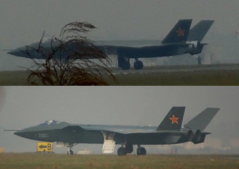

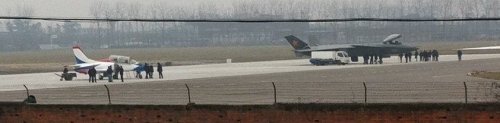

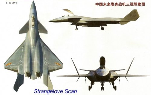

Since the J-20 appears to be more than 70 ft (21.3 m) long, I believe it is to be a fighter-bomber. -SP
Thank's a lot overscan,i'm french, "nobody's perfect".

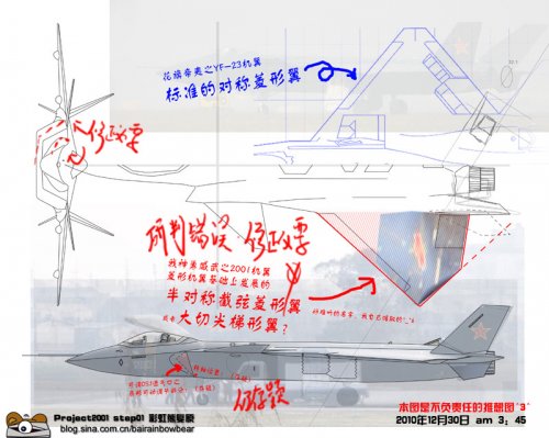

This fist one is especially for flateric if i remember his passion "YF-23"

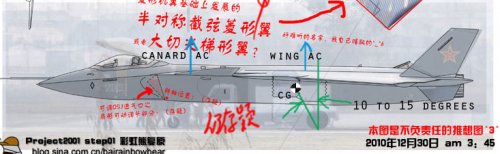

The J-20 looks extremely aft loaded. The centre of lift from those wings is going to be around ¾ down the length of the aircraft! Those canards will need to be lift generating surfaces unless the forward half of the aircraft is basically empty. I think we can rule it out as any kind of a bomber if the bomb bay is located forward of the wings because dropping bombs would so significantly change the centre of gravity of the aircraft.
Most modern canard fighter designs are slightly stable to neutrally stable before the canard is added. Here's an image showing approximates, but it's difficult to assess aerodynamic centers without good plan views. But I don't see the J-20 having anymore problems with cg and dropping weapons than the F-22. Now in this image, I just guessed the angle graphically, but land based aircraft usually have the c.g. somewhere between ten to fifteen degrees in front of the main gear contact point. It seems the c.g. to ac relationship will be just fine for a slightly unstable fighter design based on what I'm seeing.
Well the F-22 has the CG around level with the aft 1/3 of the bomb bay. The J-20 has the bomb bay well forward of the CG (using the main gear yard stick). Also look at how far forward of CG the nose is compared to the F-22 (or F-35). Either the J-20 has far heavier engines or this nose is relatively empty. If it’s a light nose then there aren’t the processors in their to give it 5th generation level situational awareness.
Seems logical enough. But this is just a prototype. Could this change as the aircraft is developed? The YF22 underwent numerous changed before becoming the Raptor.

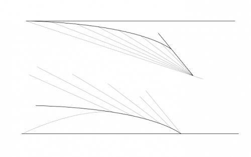

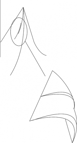

Hmmm
I believe Chinese are eager to use ride-wave theory as concept of their Fighter indeed.
But I highly doubted they really comprehended it right
The word "blow" I used above could be accurate but on DSI it should be replaced as "press".
interesting...
could work for variable compression and inlet mass flow scheduling etc. though I reckon they chose the DSI configuration with maintenance, weight savings and cost in mind.
it should be able to perform like an axissymmetric inlet(half-cone with splitter plate) like on the Mirage with engine tolerance taking care of alpha and beta sensitivity while the cone is doing the necessary compression and shock. the AL-31 family is quite known to be forgiving after all...
for a fixed intake, it would a compromise among subsonic, transonic and supersonic performance and see what best suits the mission profile and requirements. you have to give them credit for making extensive experiments with DSI research though :)

rousseau said:
ugh this could be a sort of active way to blow boundary layer up, however, since the
I have read your explanation and i like it a day ago i read an article about DSIs however i do not understand something if the bump is fixed, the position of the sonic shock is fixed, on aircraft like the SR-71 the VG inlet moves the shock cone of the inlet to adjust as speed increases, on the MiG-29 inlet for example the shock waves are create ahead of the lower lip so no supersonic flow enters the intake, how can you create a VG DSI inlet if the inlet will make the sonic shock wave inside the intake duct?
On a mirage III the half shock cone of its inlet moves ahead and aft and basicly is similar to the bump of the DSI.
I know nozzles will change the diameter of the nozzle from convex to concave depending in the nature of the flow if it is supersonic or subsonic.
but then why raking an inlet? just change the concavity or convexity of the inlet duct and there is no need of shock cone or shock ramps, i do not understand can you elaborate?

PAK FA said:
the supersonic shock doesn't have to be inside the duct per se
the pores in the bump are placed ahead of the duct and generates shock
moving the bump forward and backward in a curved duct adjusts compression by decreasing and increasing the duct's cross section
though I think doing that would require insane engineering... since you're manipulating a bump that would also require manipulating the duct's already curved geometry which means the surface should be somehow elastic... which is why I reckon the intake is fixed
I understand that but then you loose all the advantages of the fixed bump, simplicity and not moving parts and the bump is not as stealthy as a flat surface as the one seen on the F-22 chines

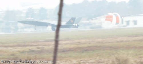

Welcome here. Thanks for the video, its the high speed taxi test. But I will disappoint you - you will never find here that kind of fiction stupidity like the Nazi UFO stories, this forum is dedicated to the real aerospace projects.

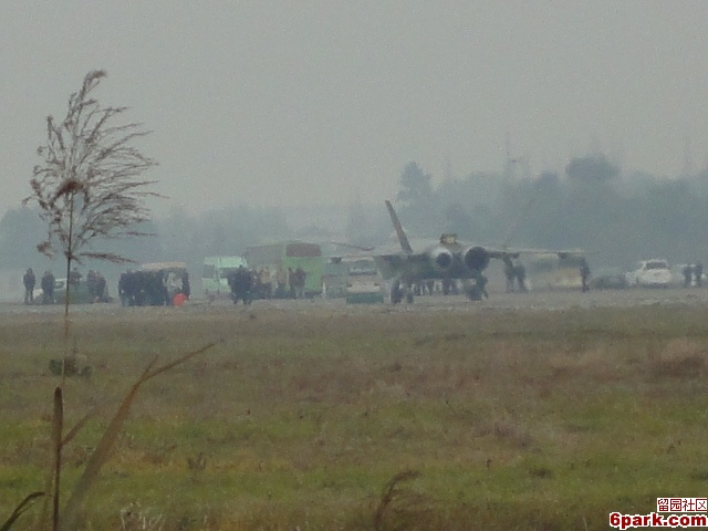

Some suggest a first flight tomorrow 6. January !!
Deino

It must be a heavy airplane, or it's on a short runway, since it has two 'chutes. -SP
One rumour is that they were almost unable to do the high speed taxi tests with the early J-10 with the front gear leg in air because the insufficient length of the runway in Chengdu. So it can have the influence.
Deino, the caption under the second photo you last uploaded reads: J-20 landing. Now correct me if I'm wrong, but if logic doesn't fail me, landing means a given object has been airborne?

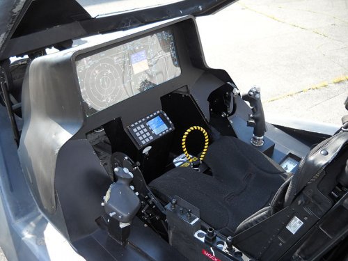

Rumoured Cockpit 1
Rumoured Cockpit 2 for 2002 【2002 is Backopening】, not for f35
NOTE: IT HAS BEEN FOUND BY USERS HERE THAT THIS ONE IT IS ACTUALLY A F35 JSF FIGHTER COCKPIT
WITHE THE LINK [http://www.youtube.com/watch?v=sHJMIOlHt1U]
Rumoured Prototype Cockpit 3 trainer
If the plane is *landing,* that means it was still airborne when it popped the drogue chutes. That seems a tad unwise. Might be a high-speed taxi test that got as far as rotation, then popped drogues.
before posting BS, check it twice (said I to myself)
gosh, they almost copied everything...but this is definitely not a flying vehicle - note, for example, lack of canopy lock units

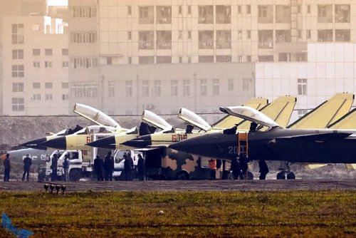

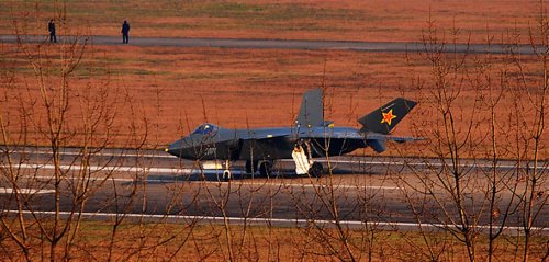

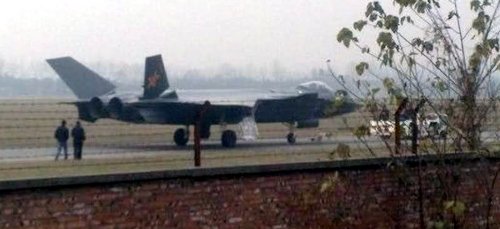

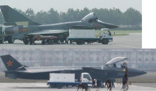

Some strange obeservations on the pictures from today ... !
With the picture on the bottom I thought to be sure that's the AL-31FN ... but now ... looks very strange and much like the WS-10A.
Otherwise I can't think that they already have both prototypes finished.

A handful of pics I found on the paralay site, don't think I've seen them here before. In the second picture the shape of the headrests suggests they've adapted the J-10 ejection seat for the J-20.
Deino, the exhausts do look different(colour, texture). There are two options here: these are pics of two different aircraft and 2001 and 2002 have been fitted with different engines( the bort number in the top pic is illegible) or 2001 has already had two pairs of engines test-fitted.
Deino
The exhaust differences are mystifying. Wait and see is probably the best choice right now.
http://www.youtube.com/watch?v=sHJMIOlHt1U&feature=player_embedded
