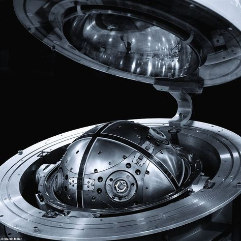

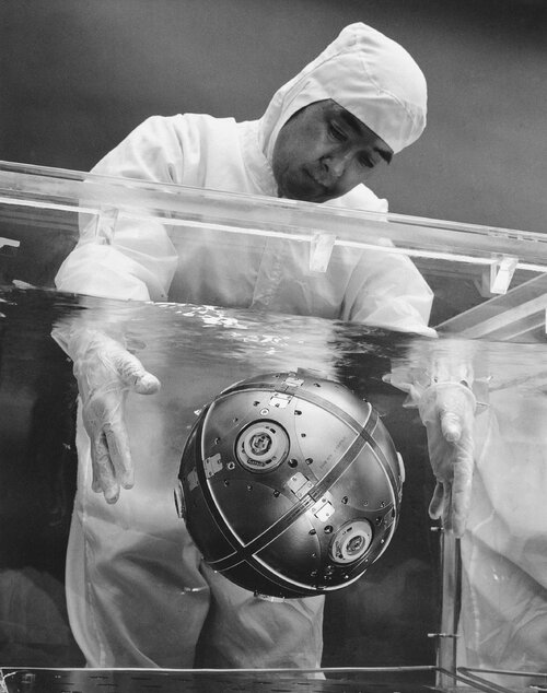

Peacekeeper Advanced Intertial Reference Sphere (AIRS) floating in liquid.

Apparently the MMIII fleet is getting these now.

Hi-res version
