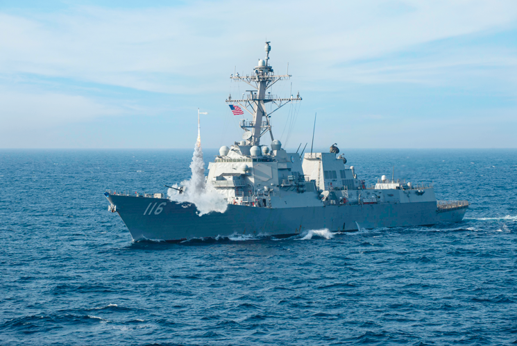

Is it really putting PAC-3s on Burkes or is it just integrating those into a common network? Because I'm not keeping tab on this and PAC-3 seems like a duplication of ESSM Blk2 kinematics.
Both. Aparently availability is the goal.
ESSM Blk2 doesn't have ABM defeat though.
The ESSM is designed pretty specifically for point-defense against supersonic cruise missiles, so the PAC-3 is a better option against ASBMs.
https://www.twz.com/sea/patriot-pac-3-missile-puts-crosshairs-on-replacing-navys-long-serving-sm-2The SM-2 is an old missile and a PAC-3 could fill almost all of the roles of an SM-2MR while adding ABM capability. The number of PAC-3s and the fact that they are currently in production is also a plus.
Personally, I would prefer a mix of PAC-3 CRIs for point-defense against ASBMs, and maybe ASCMs if they are as effective as ESSMs in that role, and a larger missile like the Talon that can take advantage of the Mk 41's volume envelope.
https://influenceofhistory.blogspot.com/2018/06/missile-loadouts-arleigh-burke-1991-2018.html
I know this page has been posted on the forum many times before, but when it comes to the naval PAC-3 MSE question, there is one very important thing to keep in mind. Even though an SM-2MR and SM-2ER take up the same cell in a Mk 41 launcher, the Navy never invested in large numbers of Mk 41-compatible SM-2ER Blk IV missiles, and they may not actually be deployed anymore. That means that, even today, the majority of the SAMs that a DDG carries at any given time are SM-2MRs, which are there to provide mass against large raids of subsonic and supersonic anti-ship missiles.
I have seen range figures for the SM-2MR of up to 90 miles (150 km), but I don't know what kind of engagement scenario that refers to (interception range for high-altitude, non-maneuvering target; range at launch against a supersonic ASCM; etc). The PAC-3 MSE appears to have a similar, if slightly lower, range against aerodynamic targets. Given that, the sacrifice in range against aerial targets is probably more than made up for by the PAC-3's ABM capability.
The fact that a third of a Burke's Mk 41 cells are taken up by Tomahawks is where the USVs come in. If they do that and use a mix of PAC-3 CRIs and MSEs (if CRIs can also replace ESSMs and be quad-packed), the loadout could be something like:
16 x SM-3
16 x SM-6
50 x PAC-3 MSEs
32 x PAC-3 CRIs
6 x VLAs
PAC3 MSE would be far superior in kinematics and divert, though inferior in magazine depth.
