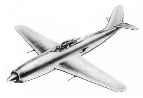

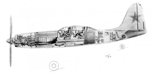

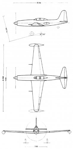

Here are some pictures of his escort fighter project, which was done as preliminary design in late 1948.
Technical data:
Wingspan - 16.2 m
Length - 13.35 m
Wing area - 35 m2
Empty weight - 5770 kg
Maximum takeoff weight - 10 000 kg
Powerplant - 1x Klimov VK-2 turboprop engine, 4200 hp
Maximum speed - 715 km/h (at sea level), 800 km/h (at 10 km altitude)
Turn time - 18 s (at 1000 m altitude), 26 s (at 5000 m)
Service ceiling - 14 000 m
Climb time - 9 minutes to 10 000 m altitude
Flight range - 5000 km (at 12 000 m altitude, cruise speed 550 km/h)
Takeoff run - 650 m
Armament - two wing-mounted 23-mm NR-23 cannons
Crew - 2
(Source: "Aviatsia i Kosmonavtika" magazine, No.2/2006)
The Sukhoi project was big enough, but nevertheless its size is still in "fighter" limits. But Pashinin S-82... isn't it enormously big for a fighter, especially for Soviet one?
