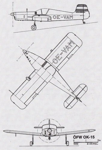

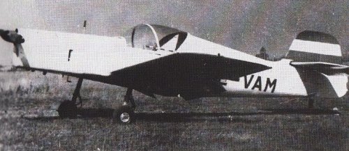

Hi
After the war there was build in Austria a two seat sports plane.
It was a design of Otto Kauba.
Who can help me with more details?
Such as:
Drawings, if possible with construction details;
Dimensions;
Pictures, if possible also during the construction;
How and in which colors was it painted;
Other details/matreials
Thanks

...this is all I have...

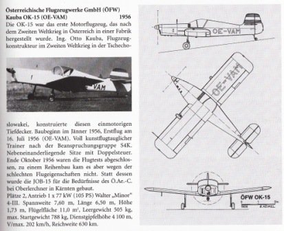

I think Keimel may have more information inside. Is that where the images already posted come from?
Maveric
Fight for yor Right!
Jan 14, 2007
1,894
263
Yes steelpillow, you´re right.
steelpillow
So many projects, so little time...
Jun 25, 2014
816
294
www.steelpillow.com
Thank you.
Here is my initial translation of his text:
Österreichische Flugzeugwerke GmbH (ÖFW) [Austrian Aircraft Factory]
Kauba OK-15 (OE-VAM) 1956
The OK-15 was the first powered aircraft manufactured in an Austrian factory after the Second World War. Ing. Otto Kauba, in World War II an aircraft designer in Czechoslovakia, constructed this single-engine low-wing aircraft. Construction started in January 1956, with the first flight on 16 July 1956 (OE-VAM). Full aerobatic trainer according to airworthiness category S4K. Side-by-side seating with dual control. End of October 1956, the flight tests were completed, but it did not enter series construction because of its poor flight characteristics. Instead, the JOB-15 was built to meet the needs of the Ö.Ae.C [Österreichische Aero Club] at Oberlerchner in Carinthia.
Seats 2, Power 1 x 77 kW (105 hp) Walter "Minor" 4-III. Span 7.60 m, length 6.50 m, height 1.73 m, wing area 11.0 m^2, empty weight 505 kg, max. take-off weight 788 kg, service ceiling 4,100 m, V/max. 202 km/h, range 630 km.
