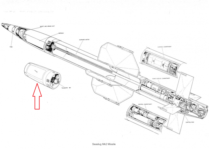

IRRC, those are either telemetry antennas from test version of missile, OR they might be emitter antennas for early versions of proximity fuxe.
Ok that explains the smaller rods... but what about those things on the wings?

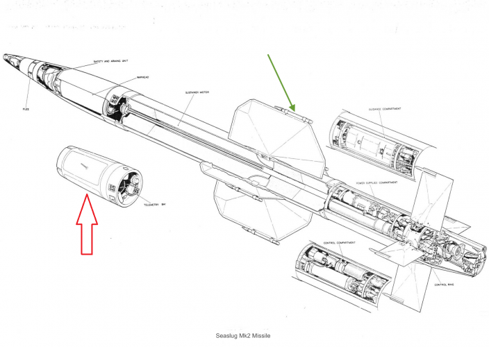

They are visible on your diagram, they look like a pencil or a tiny rocket held on by two rings. See green arrow.

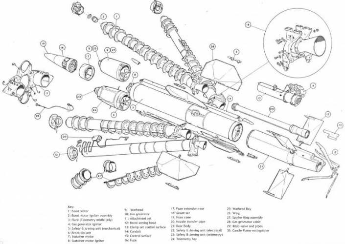

Those? Those are pyrotechnic wing flares, specifically for telemetry missiles:
