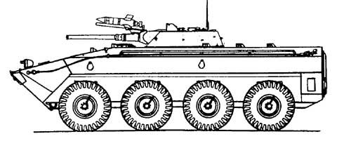

I have found a couple of drawings and pictures of the prototype, but would love to learn more about this wheeled, and one would assume cheaper variant of the BMP-1 family.
I must say the Soviet design Bureau's never cease to amaze me as into what they were willing to attempt to find a means to an end!
Thanks in advance
Pioneer
  • Side-view drawing of Object1200 - wheeled variant study of the BMP-1 MICV.jpg

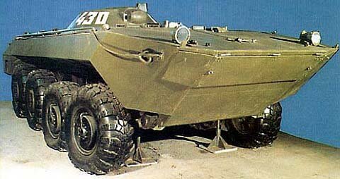

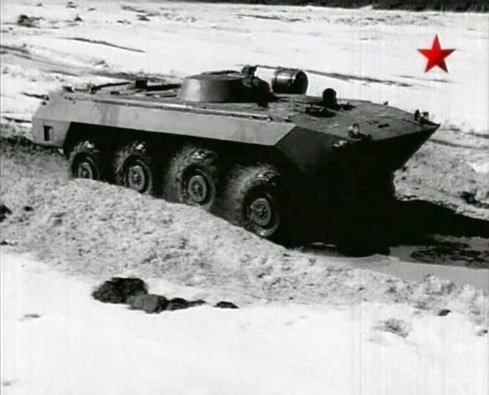

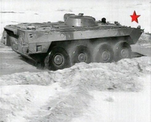

It does look like skid-steering. Most online sources compare the Object 1200's running gear to that of the BTR-60 but the BAZ prototype lacks the BTR-60's steering linkages.
Steven J Zaloga's book "BMP Infantry Fighting Vehicle 1967-94: New Vanguard 12" details the political disputes and design competition for the BMP. The Obeikt 1200 was the offering from Briansk automotive plant and used their BAZ-543 heavy truck experience. It was rejected because like the BTR-60P the all wheel ‘1200’ had major mobility limitations in snow which was obviously very important to a Russian army. It – like most of the BMP contenders – also lacked the rear door troop access of the successful Isakov KB (Chelyabinsk) bureau’s Obiekt 765.

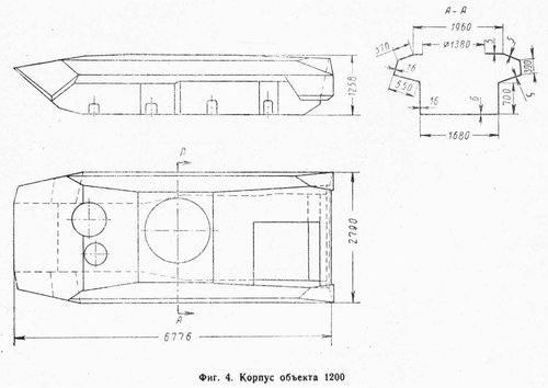

Proper drawings of 1200's hull were published in one of (previously restricted access, now issues published prior to ~1981 are unclassified in Russia, prior to 1992 are unclassified in Ukraine) Soviet defense industry's magazines, Vestnik Bronetankovoy Tekhniki (Armored Vehicles Herald) 1966-03, in article on use of computer-aided numerical simulation on evaluation of light armored vehicle hull's strength.
Malinovsky Armored Forces Military Academy was involved into design and development of this vehicle, and of several other prototypes proposed by other plants as well (obj. 019, 1015, 1020/A/B, 1040).
No information recently published in Russian indicates any influence of MAZ-543 design on obj.1200.
1200's layout with engine at the back and rear exit next to it seems similar to Western vehicles such as Cadillac Gage Commando, Mowag Wotan MR 8-01 and Mowag Roland. (Couple of years later, french designers have chosen it for Berliet BL-12 and subsequently for Berliet VXB.)
and 1200's suspension with trailing arms and ability to raise 2nd and 3rd pair of wheels could've been influenced by Panhard designs (i.e. EBR)
(though 1200 employs hydropneumatic components, instead of hydraulic and coil springs).
No information on drivetrain, though H-drive seems most probable to me, as it was used on 1015 and 1040.

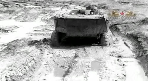

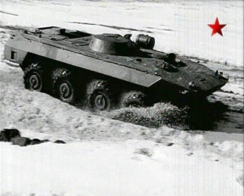

Reportedly, and judging by screenshots from test footage, first and second pair of wheels are used for steering.

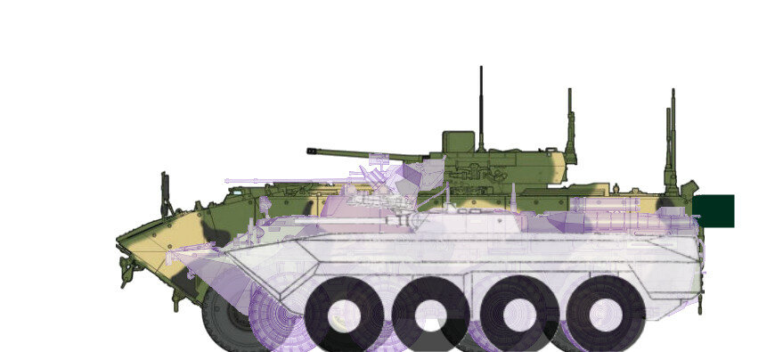

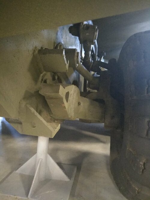

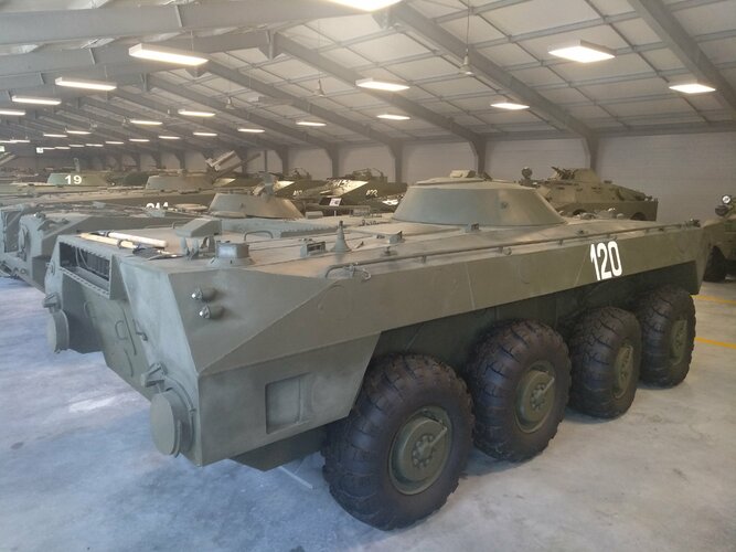

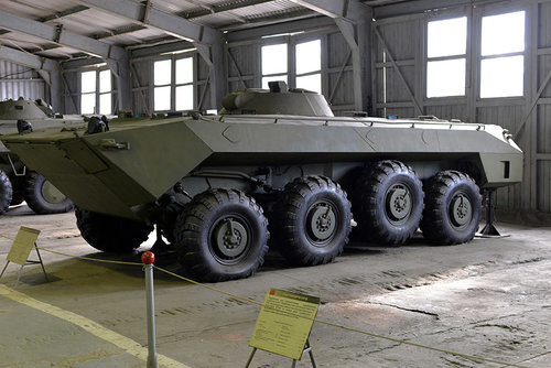

Some photos from Kubinka - after recent renovation they removed fencing, so it become possible to walk around whole vehicle and take more detailed photos. Although my phone camera leaves a lot to be desired.
Also, rough comparison of 1200 vs BTR-82A and Boomerang/Bumerang
