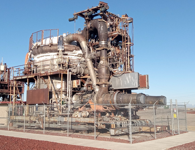

Another potential example would be the US nuclear aircraft program, which got as far as prototypes for an open circuit nuclear jet engine. The units built (know as HTRE-2 and 3) had a reactor power of ~35 MW and drove a pair of J-47 engines. It is conceptually easy to see how this setup could be used as a gas turbine for shaft power instead of thrust.
However, this setup remains quite large: below is HTRE-3 today (both are part of a static exhibit at EBR-1 in Idaho and open to the public) - note the chain link fence for scale. Some amount of this is test structure, but the reactor is not small - notional installations have it taking up some 20 ft of a 12 ft diameter B-36 fuselage, and that's the reactor proper - engine were external. In addition to needing to house all this in the vehicle, making it into a gas turbine requires the additional of a power turbine section.
Massive air filters would also be needed. Gas turbines in general require large volumes of clear air, but the open cycle nature of the plant makes this even more significant because of neutron activation.
So again we have an impractically large setup, though this one at least makes lots of power to pull itself around.

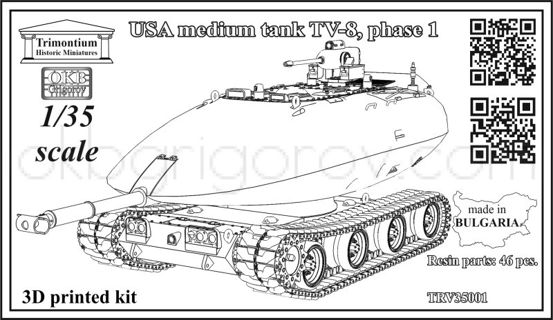

The actual TV-8 was going to use an 8 cylinder engine anyway, probably a gasoline Hemi. It was basically an M8 AGS of 1952 but it floats.
The only serious proposal for any nuclear tanks were some of the ASTRON vehicles and other Questionmark things like R-32, and they were discarded quickly because it didn't seem like the USAF would get the X-6 or NB-36 flying anytime soon, and all this led to the T95 and his 12 cylinder X-block engine.
Nuclear engines were so out there and crazy even for 1952 that they never got very far beyond someone suggesting them as one of those cool wild ideas and putting a pin in it. Kind of like undersea Rocksite nuclear missile bases for Polaris or big Kevlar blimps for the MX missile.
